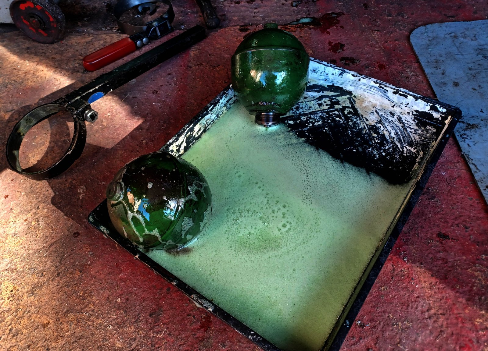

I have a FOAM party !!....rear strut spheres........
Everything is green at the moment....
