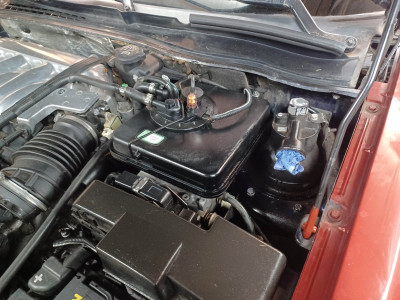

Taking stuff off and sticking stuff on .....
Strut spheres off so I can replace the piston concertina boots..........
Both (3 dimple type) front strut spheres test out @36bar

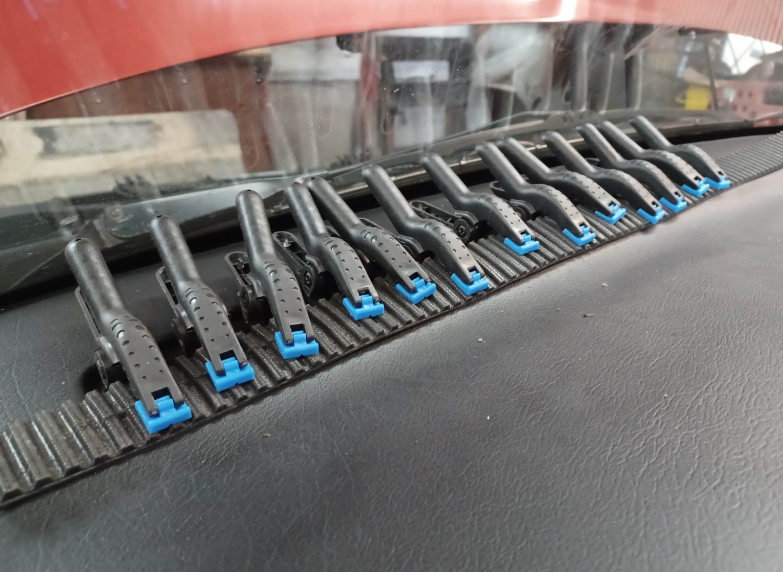

Dash demist air vents off and the delaminating bit of the dash being stuck down with 3M structural acrylic adhesive (DP8810N)
Two days clamped to "get it back into shape"
Adhesive applied, foam pad pressure
Hard foam blocks (bumper shock filling foam from an XM :) ) wrapped in gaffer tape to apply force whilst it cures, it says a few mins but I left it for 24hrs.
