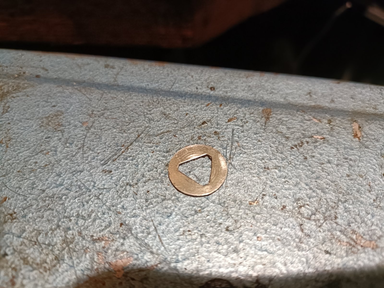

Sorry, no idea. I don't recognise it at all, don't think there any rectangular pieces in there. I've just checked my factory service manual and it doesn't show it in any of the exploded views.
This is a PSA Lucas Epic pump?
Pete

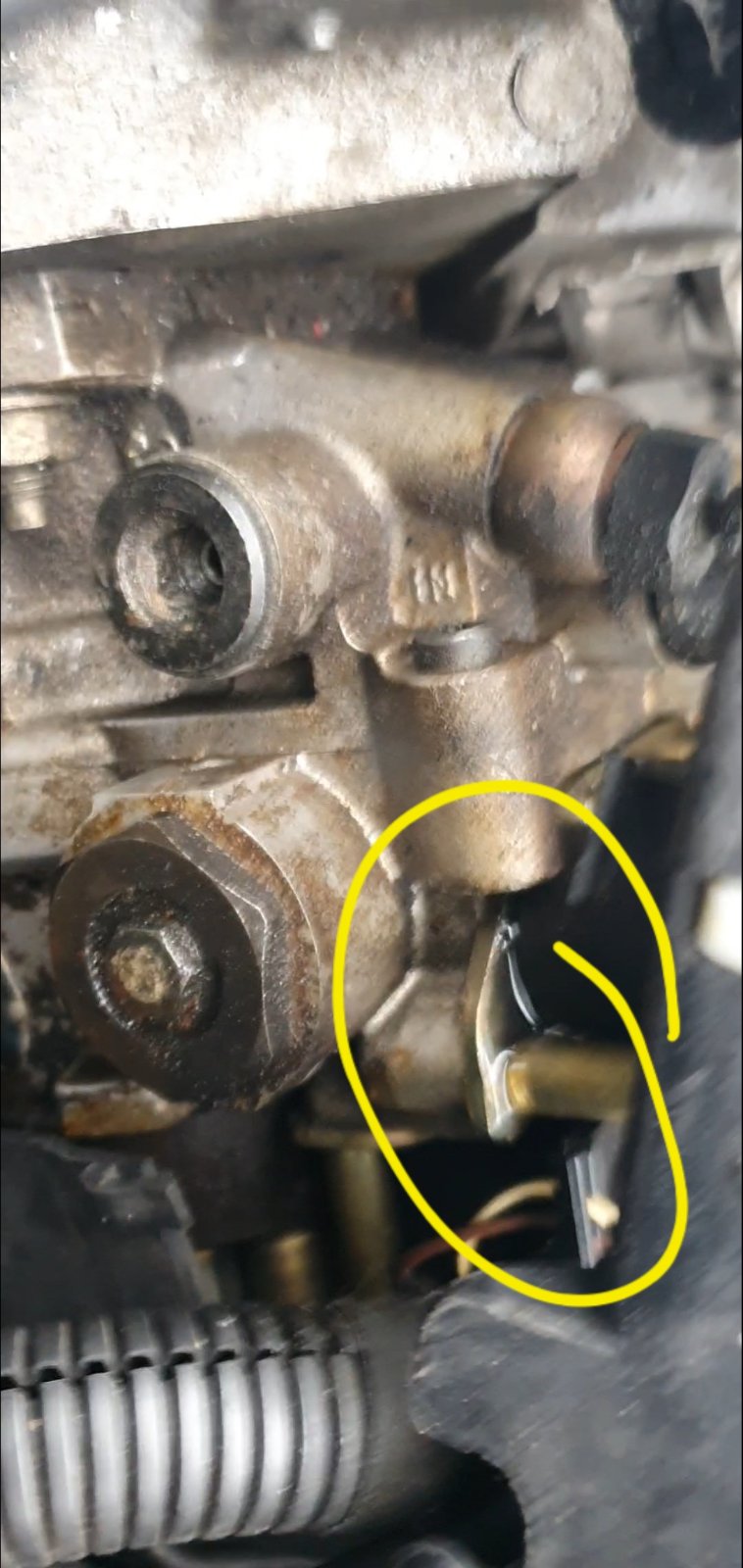

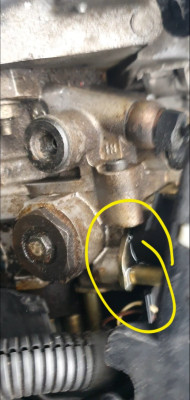

I am not sure if I have misdiagnosed the source of my leak. I had it in my mind it was the four O rings under the solenoid block where it attaches to the pump body but I have just looked again at a video I took last year when I last used the car and its gathering here (red arrow is on a stock picture and yellow circle is a freeze frame of the video of my car showing the fuel pooling)
I am now wondering if this is above the height of those o rings and hence is coming from the o rings inside the solenoid mechanism and not where the block fits onto the pump body

The 2nd photo is 90 degs out, couldn't work it out at first. Yep, quite possibly, easy to do in situ. Without rereading this thread I'm sure I posted how to and O ring sizes.
Pete
