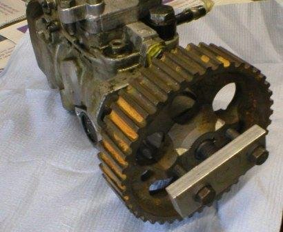

The only 'gotcha' is the woodruff key loves to make a bid for freedom when popping the pump back on its sprocket if you do it whilst leaving the cambelt and sprocket in place - absolutely the way to do it without disturbing the cambelt. It's why the pump sprocket has two timing index holes in it - so it will hold firm and in place with the pump removed... To make the key behave, smear it it loads of Vaseline and wrap a white sheet all around the cambelt/sprocket area... I once had one leap into the dark depths and had to have the cambelt and crank sprocket off to retrieve it!

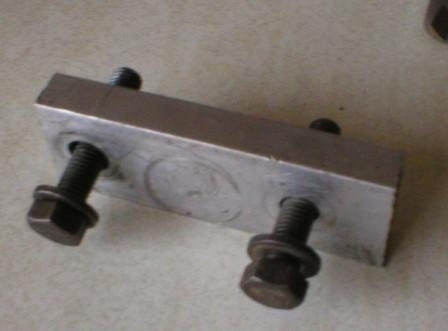

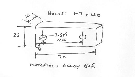

You'll need a small puller to pop the pump driveshaft out of the sprocket taper... One is easily made up using a bit of ally bar and two M7 bolts to screw into tapped holes on the sprocket face provided for that purpose. I have the pictures of the design and method of use somewhere and indeed, a search of this forum should find it. If you can't, let me know and I'll dig the pictures out from my archive...

The pump sprocket puller..
As made...
As made...
Dimensions...
Dimensions...
And in use...
Engine removed for clarity :)

The only part that can be unplugged is the round 13 wire connector that plugs into the vehicle end. The wires going into the pump are soldered, these are the fragile bits. If you're taking the pump off, when using a puller (as Jim posted), or rather in this case a 'pusher' only undo the sprocket nut a few turns, just enough for it to pop off it's taper. This way there is no way you can damage the spindle and it also allows for a 'controlled' removal because the pump doesn't try to leap into the engine bay and the key can removed easier. There is one of the pump mounting bolts underneath at the back that needs an elaborate socket, extension, knuckle configuration using both 1/2" and 3/8 to gain access.
Pete
Posts: 52853
x 7265
Re: Lucas EPIC Injection Pump Overhaul Guide
Pete, yes, it is indeed a 'Pusher' ;) And excellent advice about doing it with the nut still loosely attached :D
