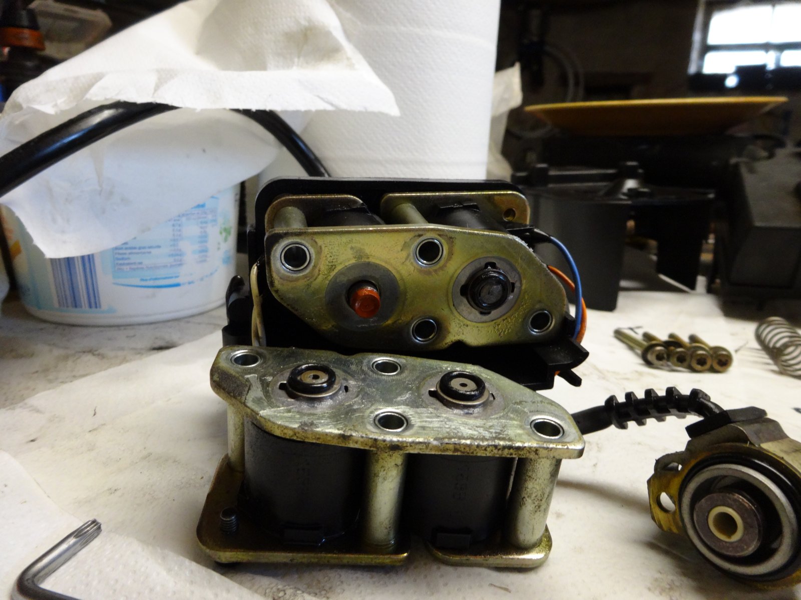

Here's a pic I've just found on 'puter
Pete

thanks, I think there are also some O rings on the other side too
- Posts: 1744
- Joined: 12 Jan 2015, 16:08
- x 371
Re: Lucas EPIC Injection Pump Overhaul Guide
Yep, there are a few
Note the top one in the pic is the stop solenoid. It's a different design to the other 3
Pete
