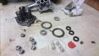

I had a strip down job in the garage today and this is what I found:
Any ideas what this is?
- Posts: 26252
- x 7084
Short answer, No but all things are lookupable with the appropriate clues.
So domestic appliance or motor vehicle?
PS Nowt like this, and a bit oily and metally for your modern washing machine
- Posts: 6410
- x 3307
Pressue washer pump head ?
- Donor 2023
- Posts: 14077
- x 3179
Looks like a triple valve bypass operation!
- Posts: 15985
- x 6781
Points go to Bobins, it is indeed the pump from a Hozelock 130 pressure washer. The lift part of the drive cam arrowed in the first picture had worn down to the point of no lift left on the three pistons, arrowed in second picture, when connected together. Result lots of spin but no pumping. I have removed the motor for future use in something as yet to be designed and recycled the rest. RIP!!
