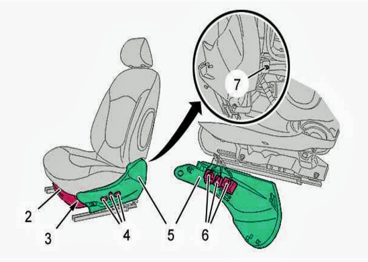

Remove the front seat.
Disengage the elastic holders , as "a".
Release the lower trim ( 1).
Remove:
  • The drawer under the seat ( 2)
  • The adjustment buttons (4)
  • The screws (3) and (7)
Disconnect the adjustment switches ( 6).
Remove the outer cover ( 5).

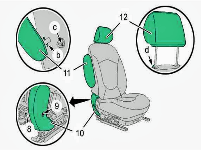

Remove:
  • The screws (8) and (9)
  • The lower seat cover (10)
  • Armrest (11) (press on the armrest and move it so as to align the lugs "b" and the notches "c")
  • The head restraint (12) (press at "d" and lift)

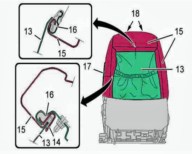

(13) Blind with map pocket.
(14) Trim profile.
(15) Seat backrest cover.
(16) Seat backrest frame.
(17) Side airbag .
(18) Head restraint guides.
Unclip:
  • Seat backrest cover ( 15)
  • The blind with map pocket (13)
Remove:
  • The blind with map pocket ( 13)
  • The side air bag (17) (see the relevant operation)
  • The head restraint guides (18) (rotate by 1/4 turn)
  • Seat backrest cover (15)

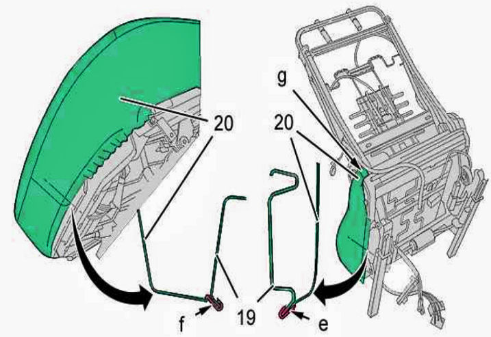

(19) Seat cushion frame.
(20) Seat cushion cover.
" e" : Seat cover side clip.
" f" : Seat cover front clip.
Unclip the seat cushion cover ( 20) (at "e" and "g" on each side and at "f" on the front).
Remove the seat cushion cover ( 20).
