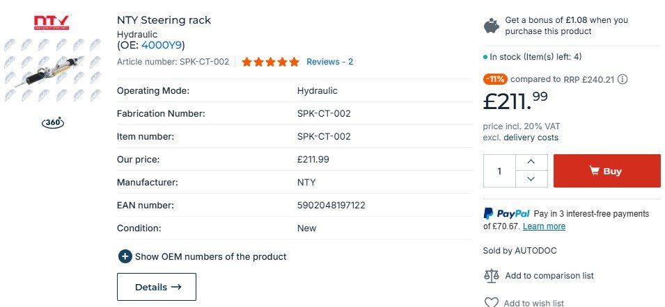

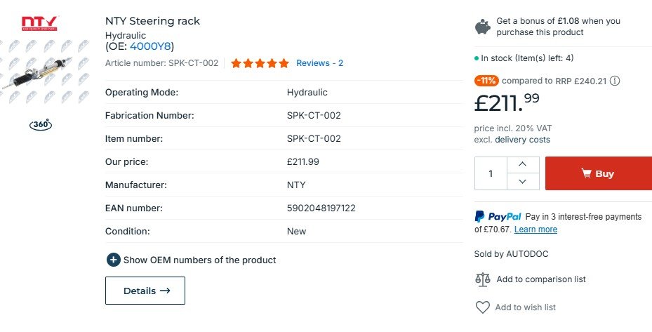

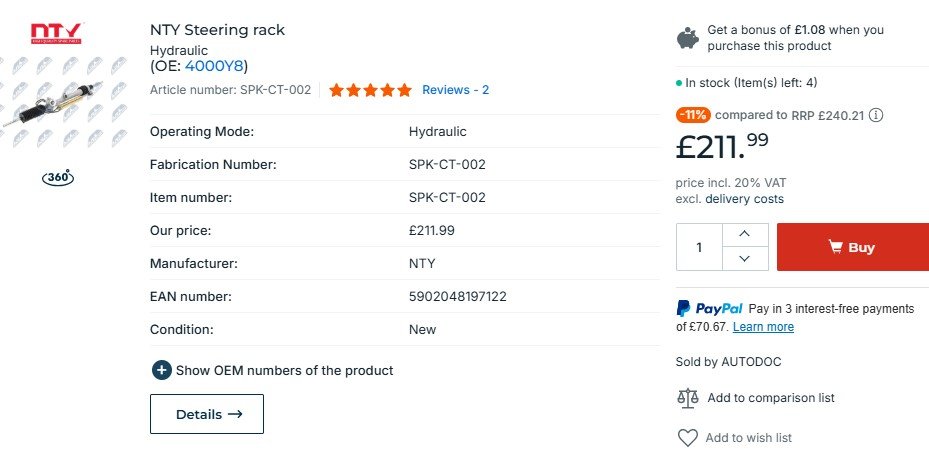

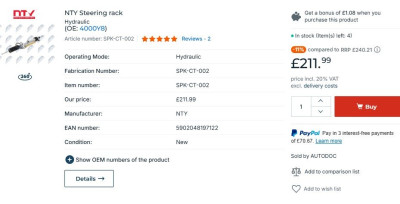

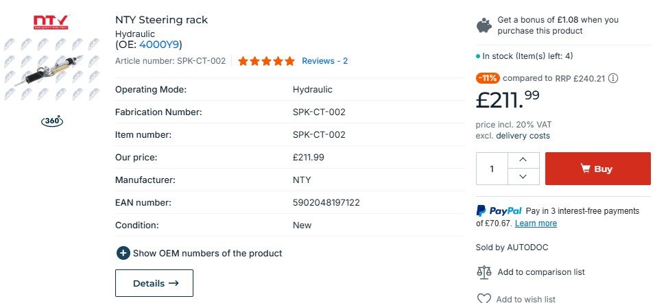

I don't know the answer but as you can see searching for each part number on Autodoc brings up the same result so that suggests they are!!
