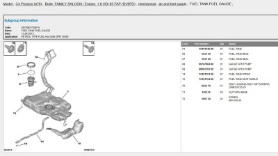

even with just a sender the hole in the tank is the same is it not ?.....and all HDI's will have a lift pump in the tank I think
as in this
as in this
