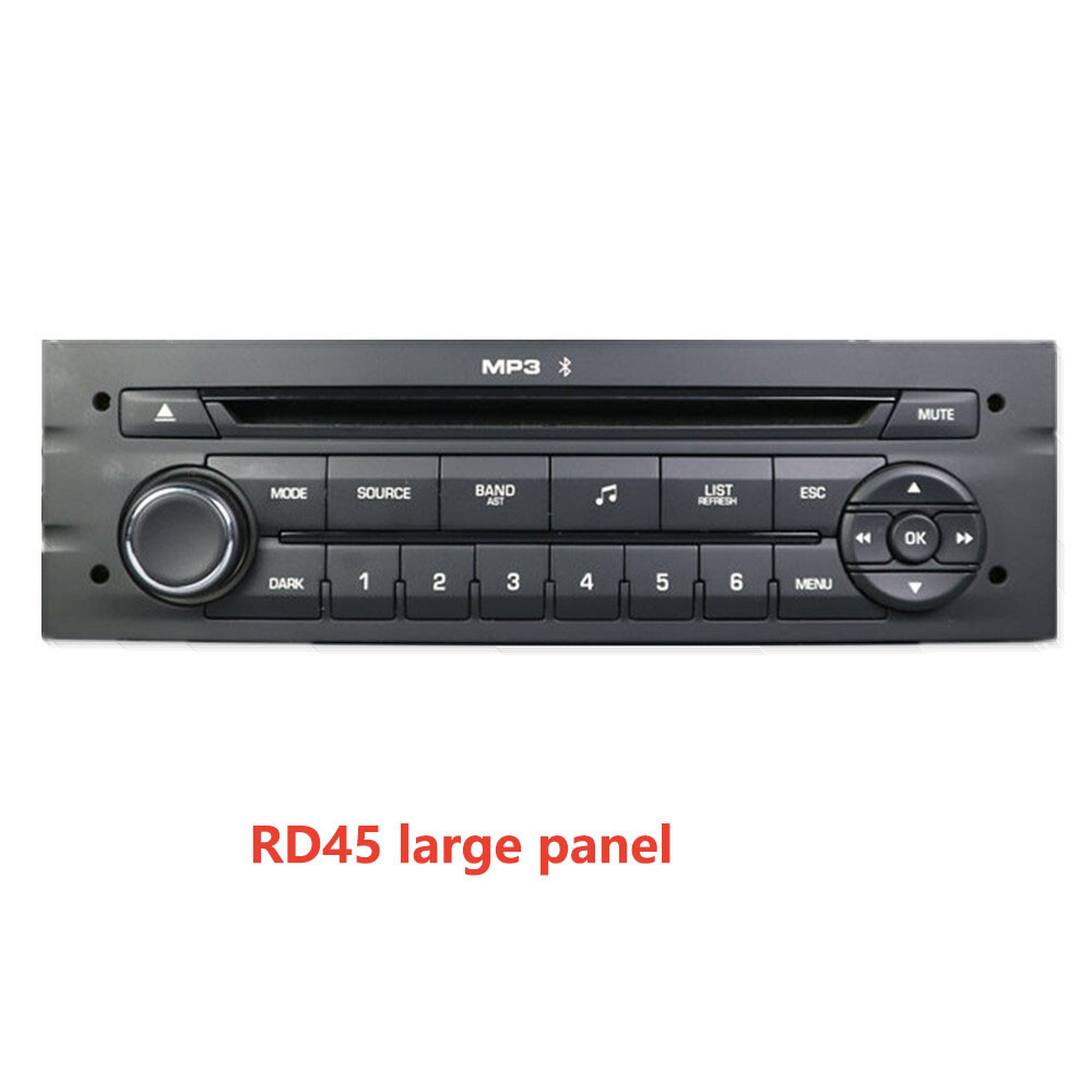

The RD45 radio I mentioned in point 3 is an OEM one?
Like this: https://www.ebay.co.uk/itm/303754747250
x 6962
Re: 2012 C4 Picasso - Change Stereo Headunit to add Bluetooth
You can buy Chinese units of these from Aliexpress and other Chinese sellers. Your existing display screen needs to support bluetooth, so needs to be and EMF-C compatible screen with later software.

I was thinking of getting an RD45 in order to have the most 'native' solution for streaming. Since I currently have call support, so there's already a microphone somewhere and the screen does have a BT menu, I was hoping it would be just a matter of swapping the head units. The current one (RD4N1M-02) has 1 antenna cable plugged on the left and a square with bundle of wires attached to the right, and the RD45 looks just like that's what it accepts (it would be evil if the wires had different functions between models).

I believe that all RD45s are essentially the same, except that some have dual tuners, and there are many variants of front panel to suit the dashboard.
You will need a central display screen with a later software version that was introduced about 2010.
