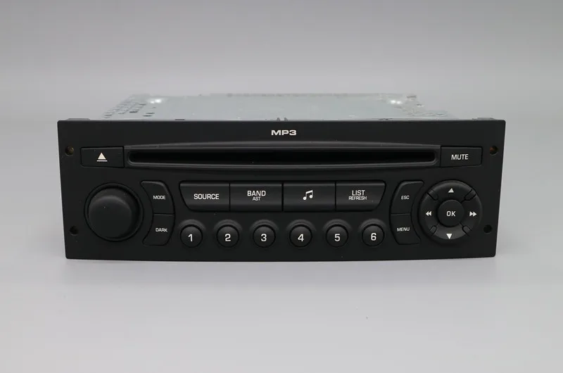

The stereo in it is, I believe, an RD4. Comme ca:

Pop your VIN up for me so I can see what the vehicle was fitted with. For a 2012, there should be a Bluetooth unit I would of thought - some of the vehicles with RD4 units may have had a hands free option, but I'll know once I check.

Ok, so this one has a bit of a basic specification, just a mono tuner RD4, no telematics unit or bluetooth.
Unfortunately on these the RD4 head unit is also more than a radio - it interfaces with the vehicle to change vehicle options - so replacing the head unit is doable, but if upgrading to a non-PSA unit will likely mean losing functionality.
So consider something like a Yatour unit that can mimic a CD player and can be wired into the RD4. From there you then attach a USB or flash card to the yatour to play MP3s and it treats it like a 6- CD changer. Depending on price and option, you may also get one with a bluetooth module for calls - so depends on the options you want. This way you can maintain the original head unit and have at least some additional functionality.

The RD45 radio I mentioned in point 3 is an OEM one?
Like this: https://www.ebay.co.uk/itm/303754747250
Posts: 42019
x 6917
Re: 2012 C4 Picasso - Change Stereo Headunit to add Bluetooth
You can buy Chinese units of these from Aliexpress and other Chinese sellers. Your existing display screen needs to support bluetooth, so needs to be and EMF-C compatible screen with later software.
