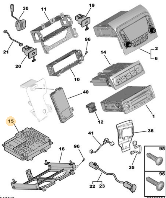

Re: Citroen Relay 2.2 150 Radio on but no sound
Ok, so back up now...
You have item (2) as your Head Unit, plus the telephone interface unit (15) and a KUANTIC telematic module item (40). This thing connects via the GSM network and GPS aerial and can provide mileage and fuel consumption data and allows other devices to be connected. It was originally used for fleet vehicle management to keep an eye on vehicles etc. (Big Brother). So if you have purchased this second hand you may find some of this kit still and spare connectors etc.
I can't tell you why your speakers are not working - there is no separate amplifier - it is integrated into the Head Unit, but if anyone has tried to take out some kit, it may have affected the electrical wiring to or from the Head unit.
