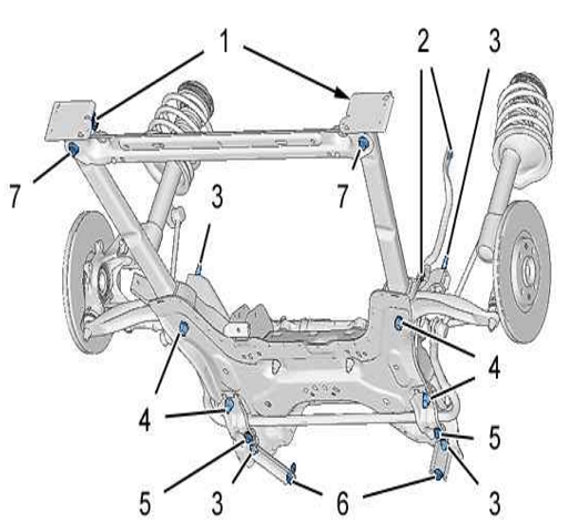

Subframe
(*) Always to be replaced whenever removed

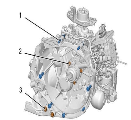

| Reference | Designation | Tightening torque |
| (1) | Bolts and nuts Coupling of gearbox on engine | 5,4 daNm |
| (2) | Screw fixing the hydraulic clutch bearing | 2,2 daNm |
| (3) | Screw fixing the gearbox impacter | 6 daNm |

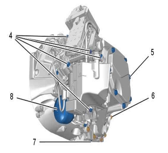

| (4) | Screw fixing the piloting actuator | 2,2 daNm |
| (5) | 6th gear cover fixing screw | 2 daNm |
| (6) | Gearbox housing / clutch housing fixing screws | 2,2 daNm |
| (7) | drain plug | 4 daNm |
| (8) | Pressure accumulator | 8 daNm |

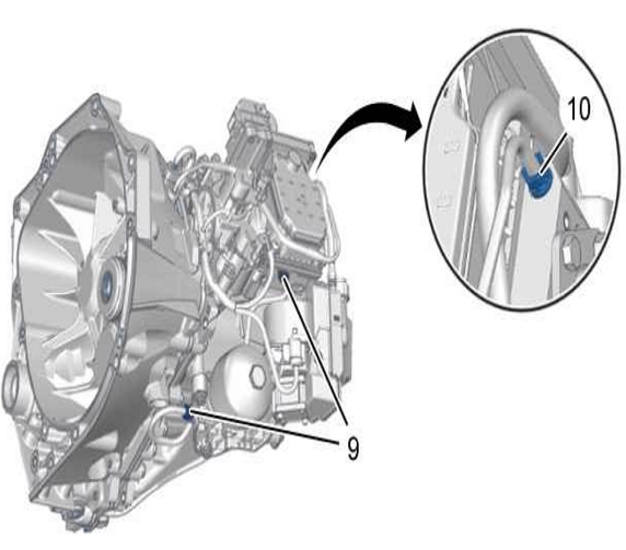

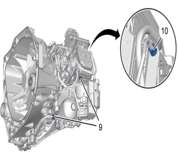

| (9) | Union (High pressure pipes ) | 2,2 daNm |
| (10) | Union (High pressure pipes ) | 1,8 daNm |

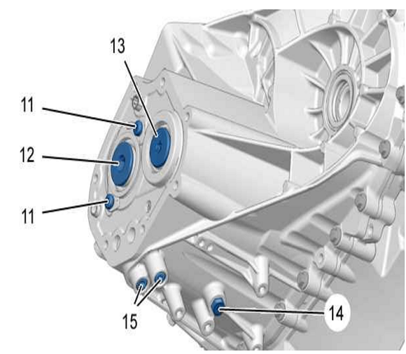

| (11) | Flange retaining screw | 1,8 daNm |
| (12) | Input shaft end piece bolt | 18,2 daNm |
| (13) | Output shaft end piece bolt | 10 daNm |
| (14) | Closer on the 3/4 fork balls channel | 1,6 daNm |
| (15) | Closer on the 5/6 fork balls channel (reverse gear) | 4 daNm |

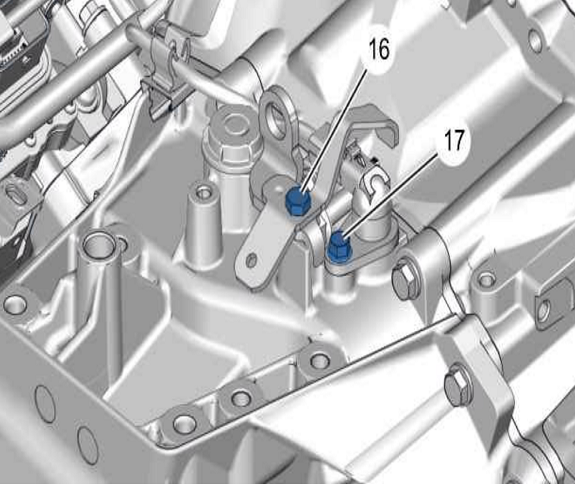

| (16) | Linking bracket screw | 2,3 daNm |
| (17) | Bolt Input shaft rotation sensor | 1 daNm |

| (1) | Bolt (Front subframe extensions) | 5 daNm |
| (2) | Nut (Front sub-frame tie rods ) | 2 daNm |
| (3) | Bolt (Front subframe) (*) | 9,8 daNm |
| (4) | Bolt-nut assembly (Lower suspension arm / Front subframe) (*) | 11,1 daNm |
| (5) | Bolt (Front anti-roll bar bearings) (*) | 10 daNm |
| (6) | Bolt (Front subframe rear mounting reinforcement / Body) (*) | 10 daNm |
| (7) | Bolt (Front subframe front lower crossmember ) (*) | 5 daNm |

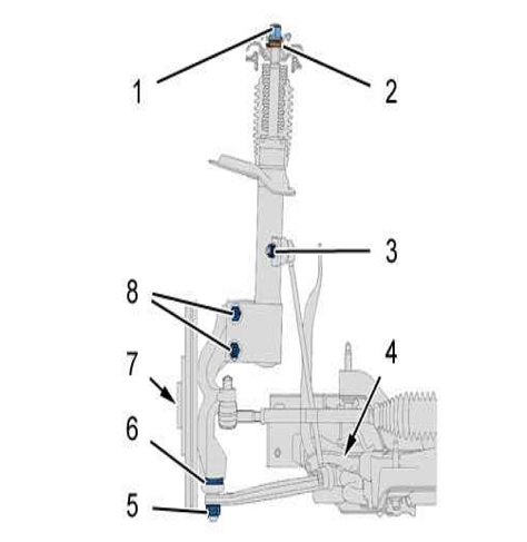

Struts
| (1) | Nut (Suspension strut / Body) (*) | 7,5 daNm |
| (2) | Nut (Front damper upper cup) | 8 daNm |
| (3) | Nut (Front anti-roll bar rod / Front shock absorber) (*) | 4,3 daNm |
| (4) | Nut (Front anti-roll bar rod) (*) | 4,3 daNm |
| (5) | Nut (Front pivot lower ball-joint / Lower arm) (*) | 4,2 daNm |
| (6) | Nut (Front pivot lower ball-joint / Front pivot) | 23 daNm |
| (7) | Hub nut (*) | 31,2 daNm |
| (8) | Bolt-nut assembly (Damper spring assembly / Front pivot) (*) | 8 daNm |

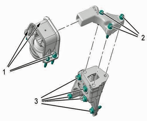

RH Engine Support
LH engine support
Lower engine mounting

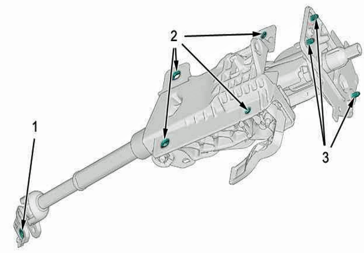

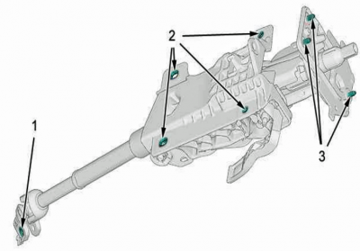

| (1) | Nut (Steering universal joint / Valve stem) (*) | 2 daNm |
| (2) | Bolt (Steering column / Crossmember) | 2,2 daNm |
| (3) | Nut (Steering column / Crossmember) | 0,7 daNm |

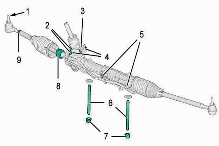

| (1) | Nut (Steering ball joint) (*) | 4,5 daNm |
| (2) | Union (Hydraulic pipe / Distribution valve) | 0,8 daNm |
| (3) | Bolt (Bracket / Distribution valve) | 1,9 daNm |
| (4) | Bolt (Distribution valve / Steering mechanism) | 2 daNm |
| (5) | Union (Hydraulic pipe / Steering ram) | 0,8 daNm |
| (6) | Stud (Steering mechanism) | 0,9 daNm |
| (7) | Nut (Steering mechanism) (*) | 10 daNm |
| (8) | Steering rod | 7 daNm |
| (9) | Locknut (Adjusting the steering track rods) | 7,5 daNm |

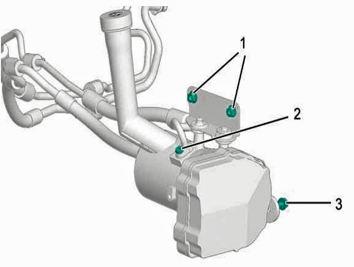

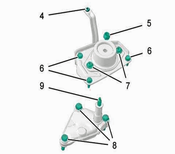

| (1) | Nut (Electro-pump / Chassis leg) | 2 daNm |
| (2) | Bolt (Bracket / Electro-pump) | 2 daNm |
| (3) | Bolt (Electro-pump / Chassis leg) | 2,3 daNm |

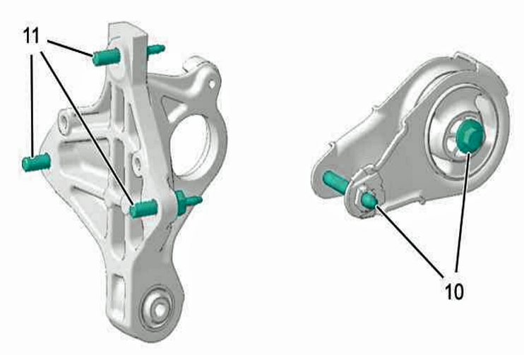

RH Engine Support
| Reference | daNm |
| (1) | 6 ± 0,6 |
| (2) | 6 ± 0,6 |
| (3) | 4,5 ± 0,4 |
| Reference | daNm |
| (4) | 1 ± 0,1 |
| (5) | 6,5 ± 0,6 |
| (6) | 1,9 ± 0,2 |
| (7) | 3 ± 0,3 |
| (8) | 6 ± 0,6 |
| (9) | 5 ± 0,5 |

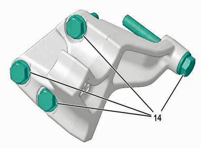

| Reference | daNm |
| (10) | 6 ± 0,6 |
| (11) | 4 ± 0,4 |
| Reference | daNm |
| (14) | 6 ± 0,9 |

As for Depressurising / Pressurising & Bleeding:
1. Depressurizing the system
- Connect the diagnostic equipment to the vehicle’s diagnostic socket.
- Switch on the ignition.
- Using the diagnostic tool : Select : Depressurisation of the hydraulic circuit.
- All the oil contained in the electrohydraulic actuator unit and in the pressure accumulator returns to the piloting actuator hydraulic reservoir.
- The piloting actuator hydraulic circuit is no longer pressurised.
- Using the diagnostic equipment : Select : Pressurising the hydraulic circuit.
- The electric motor of the electrohydraulic actuator unit operates for a few seconds.
- The piloting actuator hydraulic circuit is pressurised.
- Select: In the diagnostic tool menu :
- The vehicle
- The RPO no.
- Perform the global test.
- Using the diagnostic equipment: Select: Bleeding the hydraulic circuit.
- The diagnostic tool pressurises the piloting actuator hydraulic circuit, changing through all the gears in order to force air out of the circuit.
