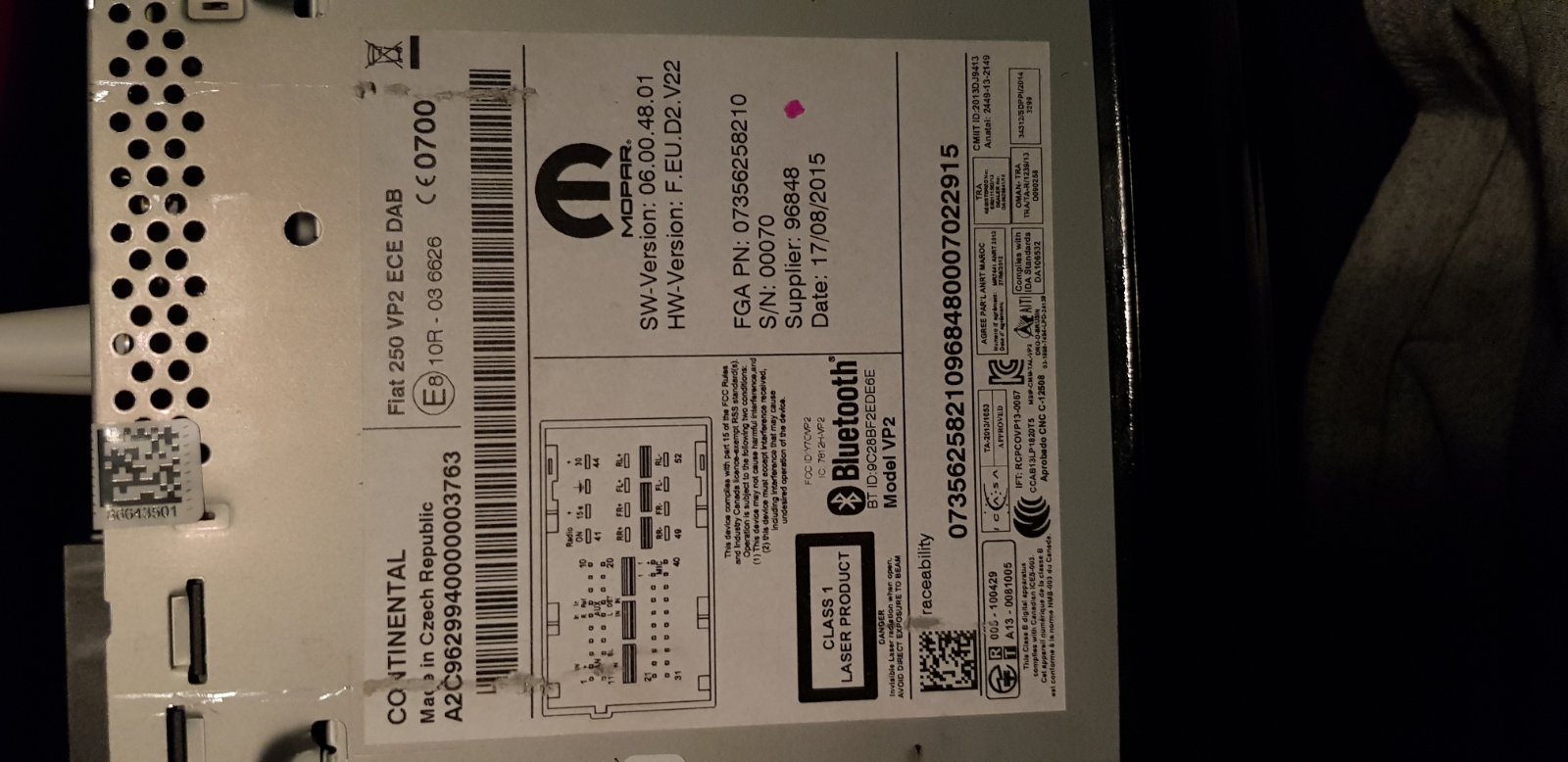

Hi I've got a dab radio but the dab function doesn't work I can see the option button but cannot select the button? I've been told I need a firmware update to get it sorted but at a cost of £150 can any one supply or show me where I can download the update? I've added a photo of radio model below

Re: Citroen relay radio firmware help
Firmware is generally free of charge as it is a system level update and usually doesn't provide additional functionality. They may charge you labour to code and undertake the update though.
I'll need your VIN to determine the specific details.
Ok this is one of those horrid VP2 Digital FIAT units. Unfortunately the software update needs to come from PSA in France via their servers, so will be a dealer visit to update I suspect.
