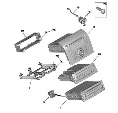

Re: Citroen - Relay - Bluetooth problems
Ok, so now I have your VIN.
I'll be straight upfront here. This van is a Jumper III - joint PSA / FIAT collaboration with the Ford Puma engine! These are also similar to the Fiat Ducato vans.
As such, they are not true PSA systems, so I have no information or documentation on these. What I can tell you is:
1) It is a Blaupunkt system radio made for Fiat, part 1 in the diagram below.
2) According to the specs for your vehicle, I cannot see a bluetooth module listed, but the part is shown as part number 15 in the diagram above and is just referred to as 'Box'!
3) Part 15 in the diagram is commonly fitted to Peugeot Boxer, Ducato, Relay (Jumper) MK3 and is a Bluetooth Handsfree Module ECU. So it is this part that will handle the calls and bluetooth functionality and pass this on to the audio system.
So was this module (part 15) retro-fitted to the van at a later date or was it factory fitted to start with? The reason I ask is that if it was fitted at a later date, was it correctly coded and configured to the vehicle properly. If it was original or has been correctly coded, then I suspect that it is faulty - OR may need an update. How this is done will either be through an upgrade using the USB key or via a dealer level diagnostic tool like Diagbox and a firmware update via the PSA servers - if in fact it is possible to update this unit. Only the dealer will be able to advise you of this.
Here is a link to a replacement module - but I wouldn't want to advise that you replace it without first checking the route cause:
https://www.ebay.co.uk/itm/GENUINE-Peug ... 3207074923
I would also suggest that you delete the phone that is paired from the system and try re-pairing it again. I note you have an iPhone 7 - so what version of IOS is the iPhone on? If you have updated the iPhone to IOS 11 - it is full of bugs and has rendered thousands of iPhones unusable (especially the iPhone 6 series). IOS 11.2 has just been released to the public - you may want to try that as there were issues with bluetooth connectivity. Having said that - sometimes updating is not always a good thing if the newer updates cause compatibility problems with your van's older bluetooth software.
So if you already have IOS 11 on your iPhone, then you cannot go back to IOS 10 now as Apple have stopped signing that firmware. So make sure you have the latest IOS 11 update. Secondly, after you have updated it to 11.2, delete and re-pair the phone with the VAN again.
Next, if that has not improved matters, you can try one more thing - Go to your iPhone - SETTINGS, GENERAL, RESET and choose the RESET ALL SETTINGS option. This won't touch your Apps, but will reset all the network and bluetooth and some other settings. You'll need to re-enter your wifi passwords and check your privacy and notification settings - but has been shown to make a vast improvement to many iPhones.
Then try and repair the iPhone to the van again after first deleting the existing pairing. Be aware that it may take a while for the address book to re-synchronise.
Regards

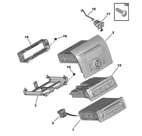

Regards
