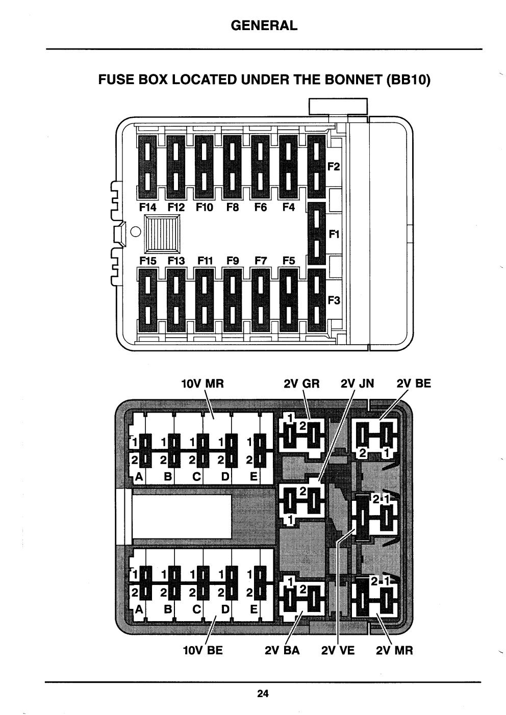

Do you have a any fuse box diagrams showing what is what by any chance?

Cento, if you can post your VIN, we should be able to post fuse box details for the car.

Re: Activa procured!

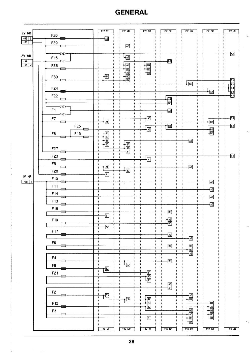

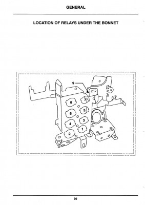

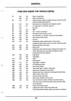

Hi Liam,
Xantia 5dr Saloon 2.0i 8v turbo BVM5 XU10J2TE
RPO 6944 (= 13Nov1995)
Fuses and relays...
Source: EWD BRE0071 Oct.'94 for MY1995
Fuses and relays...

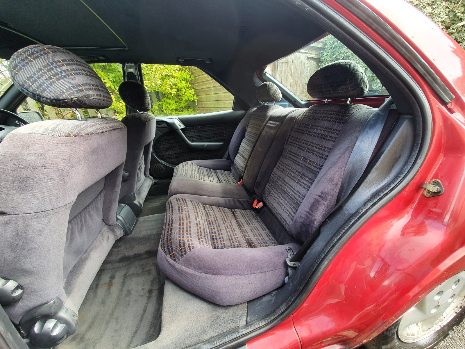

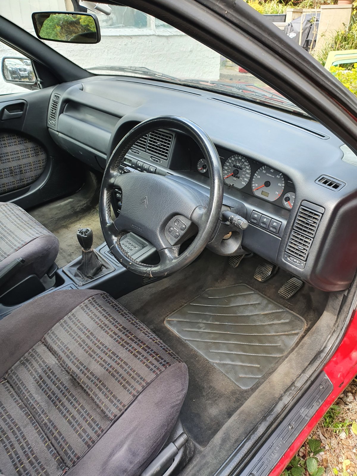

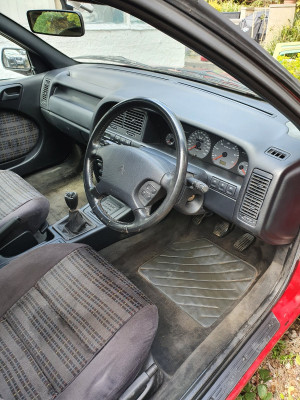

Well, its certainly somewhat more habitable after today!
Absolutely knackered, wasn't helped by the OSR door not opening either!
Ah well, all is forgiven now I'm in the beer garden!
Cheers Jim, it certainly smells it
Ran out of time (and energy) to do anything productive as I had to fit a new boot harness to my XF as well (common fault).
Next job is to try sort out why the osr door doesn't work, check some fuses and get the central locking working, and then spheres are the big necessity so I can start driving it!
