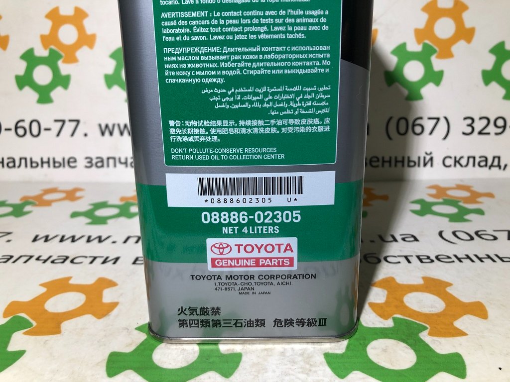

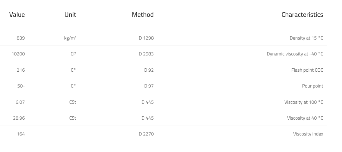

Hi
is it ok to use this oil "ATF WS Lifetime" specs are shown in the images
my vin code is VF3**************[VIN obfuscated, can be read by forum staff]
