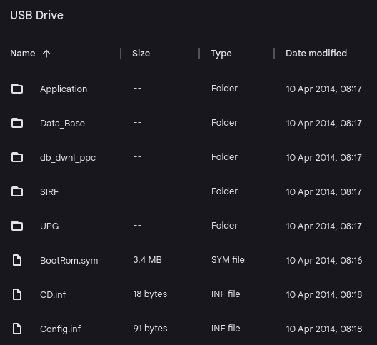

It's beginning to sound like the RT6 unit might have had it.
One last thing to check. What file(s) did you put on to the USB drive? A screenshot of this would help.

Hey Paul,
Thanks, here's what's on my USB.
Cheers
