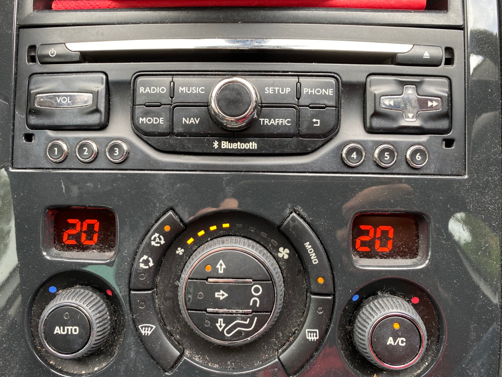

Hi Folks
This is my first foray into RTx stuff.
Is this system in SWMBO’s 3008 an RT6 unit please?
Looking at the photos and descriptions it appears so.

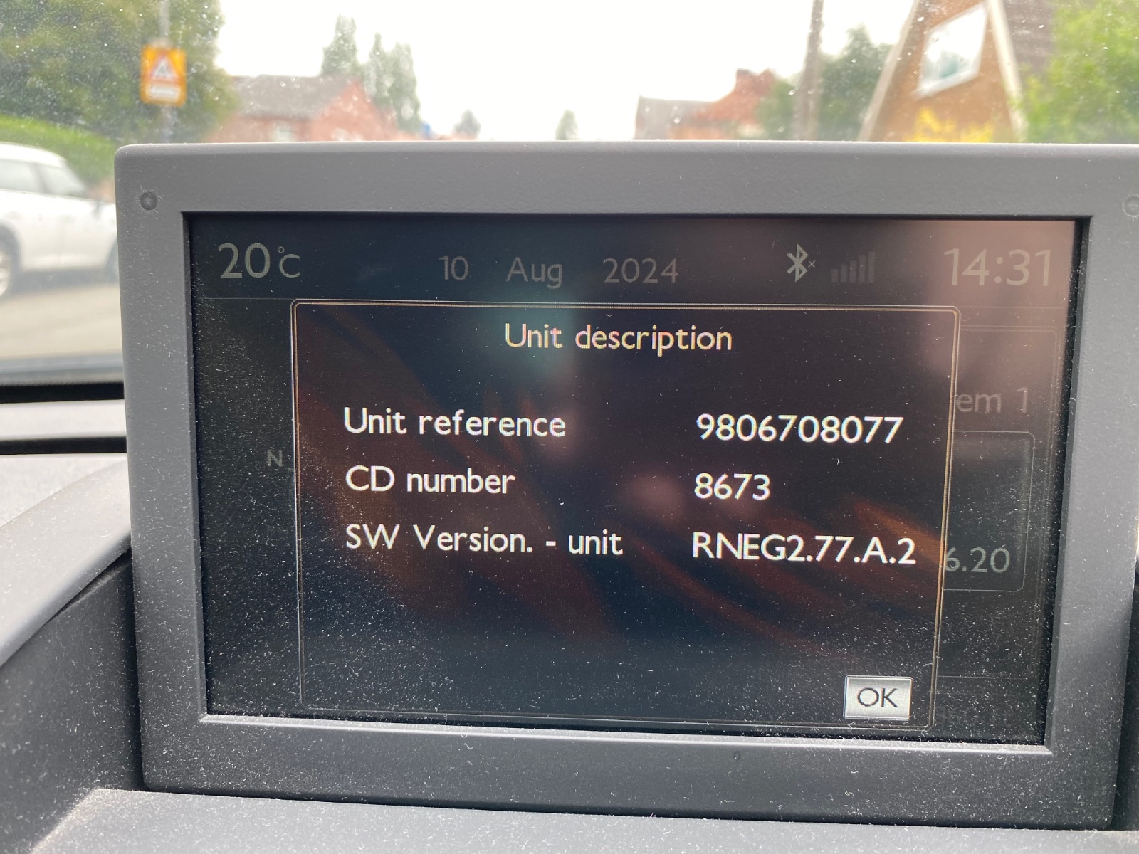

There are about 15 screens with different information on about the SW version.
What is the latest firmware/software that anyone has on here that would be willing to share it please?
I’ll do an internet search too in the meantime. There is no rush but I’d rather trust a forum member than a random site ie someone that has tested it beforehand.

1) Yes this is an RT6

It has 2.77 from memory. Definitely not 2.86. It does give the warning on the packaging thus:-
MANDATORY: Following this upgrade, if the previous software version wasn't 2.3x or 2.7x or 2.8x, an update of the radio navigation system calibrations have to be done using the diagnostic tool.
So does that mean, I am fine?

Ok, so 2.77 would suggest this should be fine, but yes, always do a backup so that the data and configuration can be restored after the updated firmware is applied if needed.
If replacing the MicroSD card, make sure you get a 16Gb version to allow for the increased map sizes of later map updates, make sure it's a Class 10 card.
