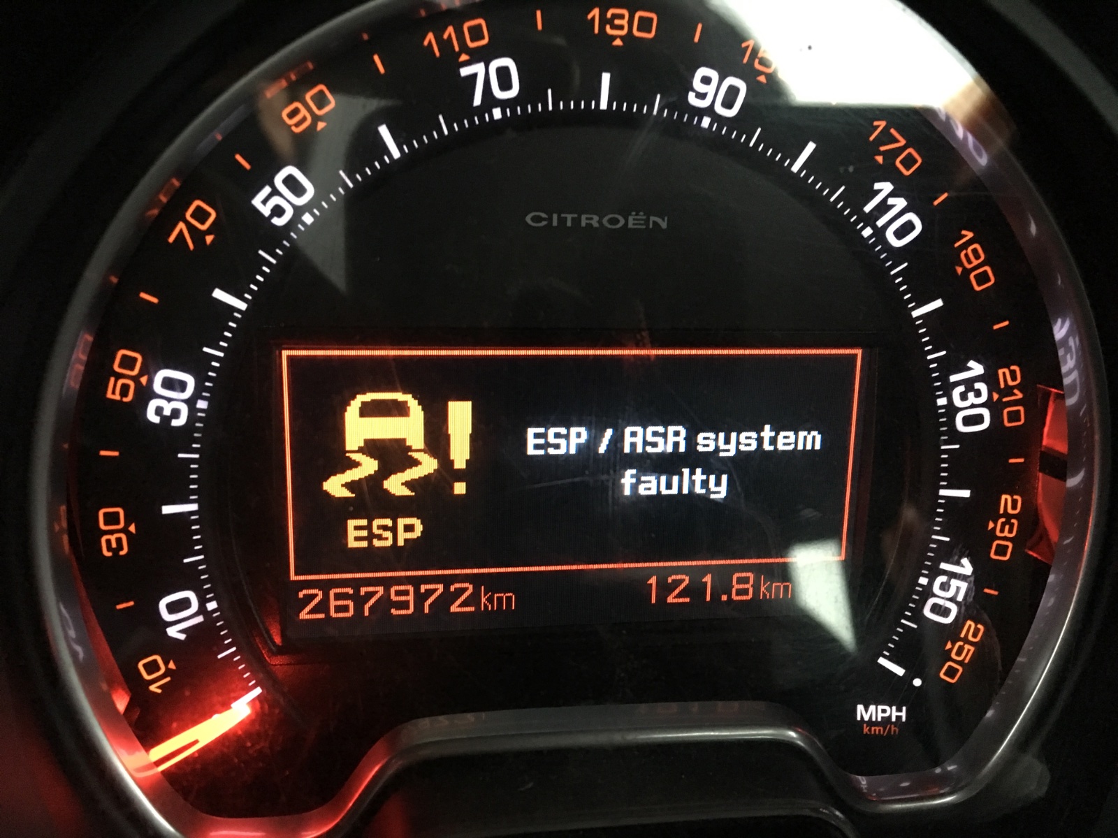

Hi guys,
I’m on the road is snowing and freezing outside and I’ve just got these errors.
What could be the problem and is there anything I could do to solve these?

Hi Dani
That means there is a fault detected by the ESP ECU tha also controls the ABS. As a safety precaution, it has disabled the ESP and the ABS system, so be aware of this if driving in the snow - as you'll only have standard braking now.
It could be a faulty ABS wheel sensor, but there will probably be a fault code that will help point the finger at the suspect area. If you have Diagbox, pop the fault code up.

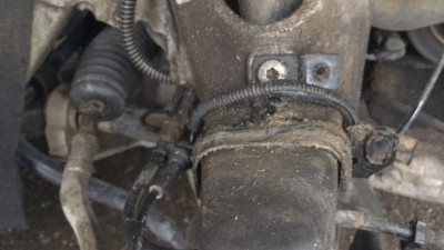

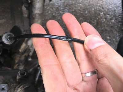

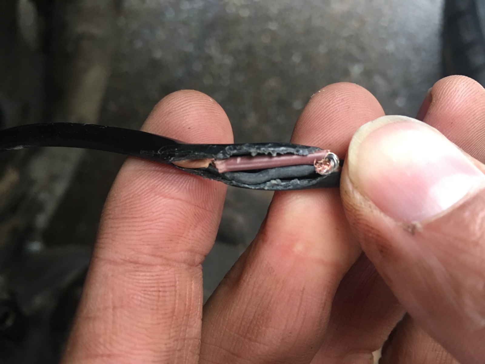

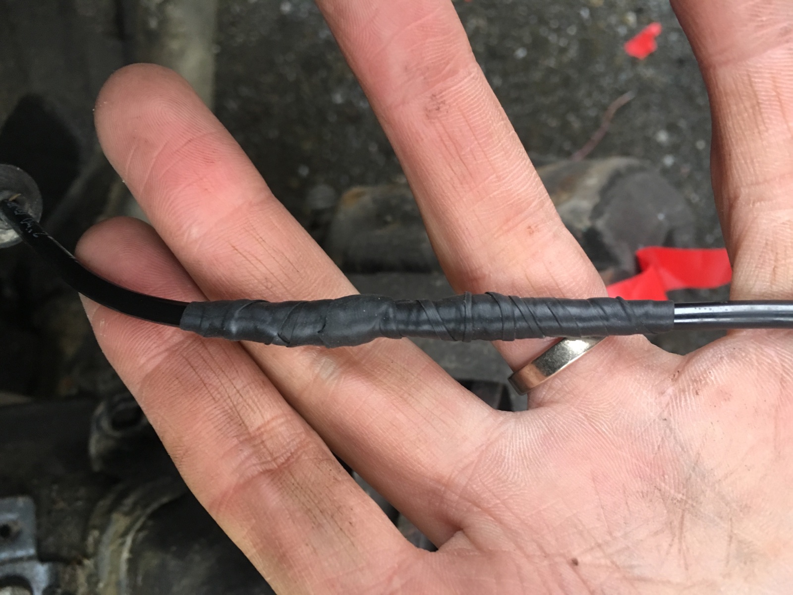

I managed to solve the problem.
The cable from the sensor was punched. I fixed it and now it works perfectly.
Thanks everyone for all the help.
Posts: 42019
x 6911
Re: ABS, ESP, ASR System faulty
Well done, I was just about to sort put some pics up, but you beat me to it. Looks like it got caught or trapped somewhere!
