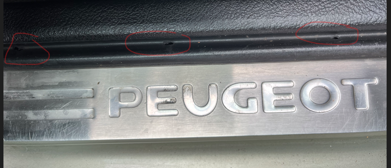

Re the 407 door seal issue and airbag warnings, after a few days of rain and testing with the hose, I gave up as water was still pooling on top of the bottom door seal and then running inside the car.
My solution was to put a few holes thru the seal with a leather hole punch tool which seems to allow the water to exit (the door seal gets squashed when the door closes)
Not ideal but the only solution I could see bar a new door seal which probably would not help anyway

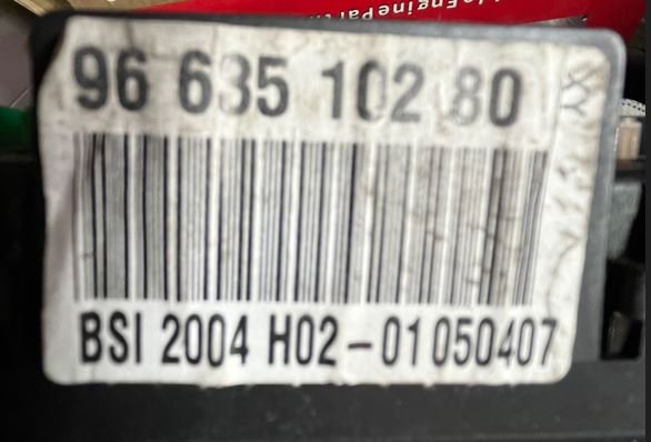

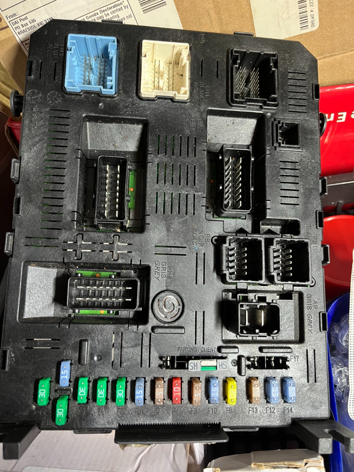

I need you to confirm the type of BSI you have as there are specific diagrams for each. The problem is that your VIN doesn't state which you have (as both types could of been fitted during the changeover).407 wrote: 07 Nov 2024, 10:08 Hi Marc
I have a long standing intermittent C613 code on my 407 ES9 which Diag helpfully says is Rear right satellite or front right door fault.
I thought it was the crash sensor behind the drivers (part 9636982680) as it was water logged but suspect some other connector is poorly.
Do you have a loom diagram showing where the air bag / sensor connectors are on the drivers side (right hand drive)
cheers
ps - the carpet is now dry so holes in rubber seal worked
It should be either a Siemens unit for non-BSI Evolution + Com 2008 or
BSI Evolution + Com 2008 (JCAE or Visteon)
To help, these should have distinguishing features to identify them.
| BSI Evolution | Non BSI Evolution |
As soon as you can advise, I can provide you with the correct diagram.

Re: Airbag, Dashboard, Seat Belt & Airbag ECU Repairs
Looks like I have the BSI Evolution one

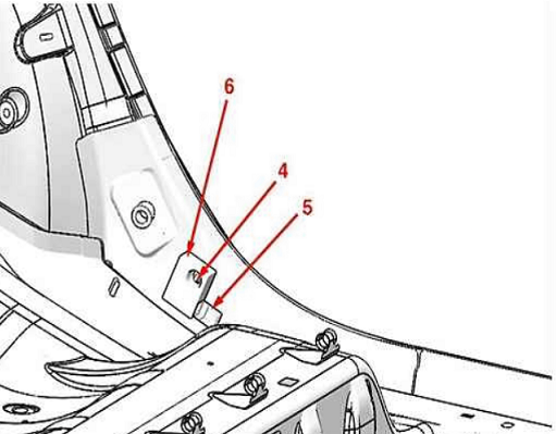

So this is where the rear satellite sensor will be (ditto for either side):
Diagram

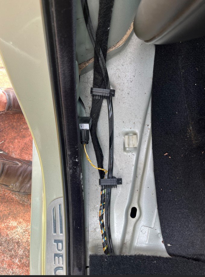

Thanks Marc

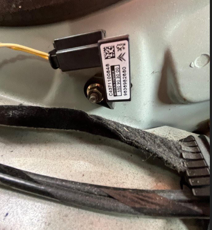

So pulled the driver's rear door floor panel off and found the rear satellite sensor 9636982880 pretty easily (see pic)
Pulled the plug on and off as few time plus some sprayed some contact cleaner but no change in the air bag warning (eg came back on) on my test drive.

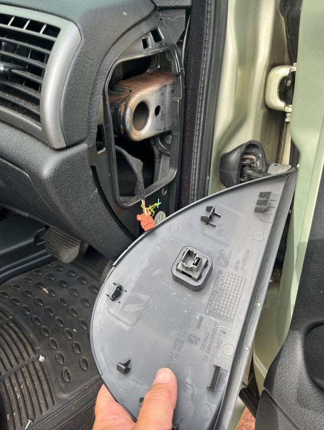

I pulled the front door driver's kick panel cover off but could not find any sensors there - any idea where the front one is ?
Also, do the connectors to the air bags in the doors or in / under the seat affect the C613 error or is it just in respect of the rear and front satellite sensors ?
I have assumed the sensor itself is okay given most times the air bag warning disappears but may swap it for the passenger side and see what happens / the fault moves to that side - any other way to test it ?
Of interest, there is a panel on side of the dash (drivers side) that I pulled off in my search - I removed the plug but its not connected to an thing -any idea ? Maybe a option to disable a passenger air bag on left hand models ?
