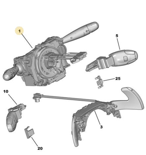

Hi, no problem and thankyou for your donation.
The Com 2008 unit is item (1) on the diagram.
The Official part number is: 96773881ZD and currently retails at Citroen for £425.46 inc. VAT.
There are used ones available, like this one on ebay for £99 taken from a 56k mile 2014 DS3 with the same part number:
https://www.ebay.co.uk/itm/274380951742
If going for a second hand one - try and get one from a vehicle with as little mileage or a later vehicle as you can, as this will give you some confidence on less wear. Make sure you only get one with the 96773881ZD part number though.
Also, bear in mind when you replace these, you will need to recalibrate the Steering Wheel Angle Sensor as you have ESP on your vehicle. Without doing this, the ESP system will throw a wobbly and deactivate all of these features. You will need a mechanic with access to Diagbox or another professional diagnostic tool with this capability.
One other thing, be aware that the audio and cruise control supplementary stalks are not usually supplied - unless stated, the existing units are easily detached from the module and reinserted into the new comms unit. I think the one in the link I provided is complete - so that will be good as you can just replace the entire unit.

The cruise control and audio stalks can easily be removed (there is a latch on the back of them that can be accessed from behind). You will need to remove these stalks before unclipping the top steering shroud, otherwise you will be wondering what is holding it in place (you can guess how I learnt this!).
