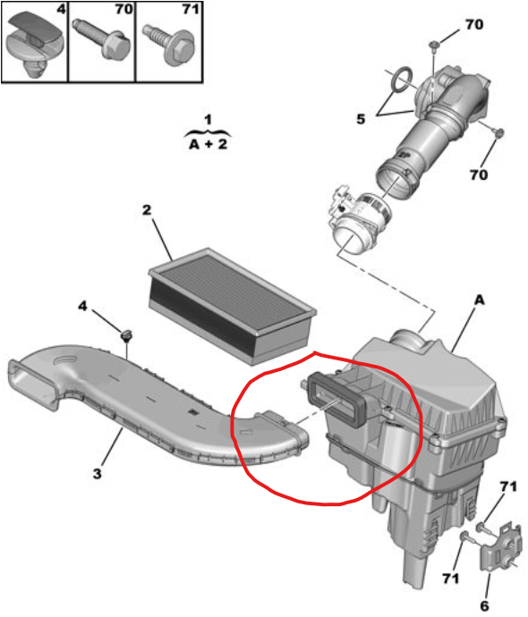

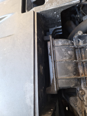

Do I understand correctly that one end of component 3 has to go into the opening of component A, i.e. into the box?
For me the whole box fits completely loosely.
I have all the plastic clips on
GOOGLE TRANSLATE
Posts: 42019
x 6922
Yes, pipe Item (3) connects as shown to the air filter box. But the pipe itself may be loose, or if the whole box is loose, then it may be the inlet resonator support shown at (6) with screws (71)

Do you also have the part number for the others?
GOOGLE TRANSLATE
Posts: 42019
x 6922
Other what? Please state the item numbers from the diagram, I'm not Psychic. :chin:
GORAX
Posts: 165
Joined: 08 Jul 2024, 12:55
x 11
Unread post by GORAX »
3,6 and 71
GOOGLE TRANSLATE
Posts: 42019
x 6922
(3) Air Intake Pipe, part: 9672026780, £21.10
(4) Rivet, part: 1622749580, £0.23
(6) Inlet Resonator Support, part: 9676891780, £16.28
(71), MUL Screw and Washer, part: 6922C7, £2.47

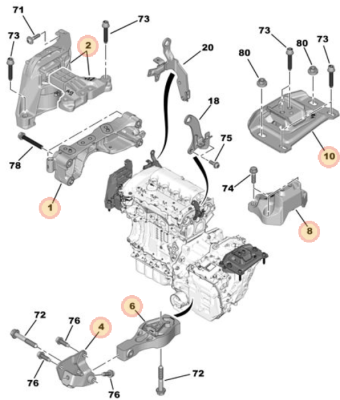

Can I pls. Have the part numbers for the engine + transmission mounts of a Citroen c4 Picasso, 1.6 petrol, 165bhp vin number VF7**************[VIN obfuscated, can be read by forum staff]
thx
Posts: 42019
x 6922
(1) Engine Mounting Bracket, part: 9673585680, £149.63
(2) Engine Mounting Bracket, part: 9820296280, £194.57
(4) Engine Mounting Bracket Left, part: 1610975280, £97.32
(6) Anti Torque Link, part: 9808838680, £103.87
(8) Engine Mounting Bracket Left, part: 9673773080, £99.74
(10) Engine Flexible Mounting Left, part: 9673768480 , £192.62

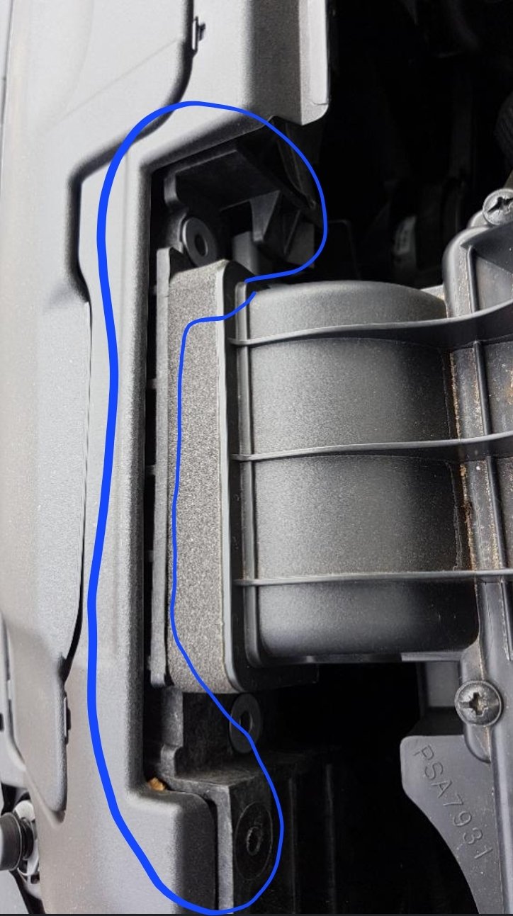

Thanks for the info! But I'm still missing this part

That is the pipe (3) going into the Air Filter Box (A).

Those parts in blue are likely the front frame mounting parts and brackets - If they were loose, they would be rattling - that's not going to be the issue.

I miss them completely. Is it part of the air filter box or the front frame?
GOOGLE TRANSLATE
Posts: 42019
x 6922
I can't help you specifically as you've used pictures from a different vehicle that shows it in place and above without the pipe - which looks like it has been ripped off or missing completely. These are the parts in the diagrams, so you'll have to determine what it is you need. I can't tell you any more than is shown, as I don't have the vehicle in front of me.

GiveMeABreak wrote: 27 Oct 2024, 12:49 Image
thanks, can you indicated the OE numbers for the screws/bolts as well ? i presume these are streching screws (need to be replaced) ?
Posts: 42019
x 6922
(71) MUL Shaft Screw, part: 1803Q2, £1.85
(72) MUL CZX RDL Screw, part: 9853111280, £5.71
(73) MUL CZX RDL Screw, part: 9824221380, £4.18
(74) MUL TH Screw with Washer, part: 6922G7, £3.53
(75) MUL CZX RDL Screw, part: 6913V1, £2.41
(76) MUL CZX RDL Screw, part: 6913V6, £3.53
(78) MUL CZX Screw, part: 180392, £4.32
(80) Self Locking Nut, part: 9676021580, £3.37
There's nothing specifying replacement of these, but I guess it's up to you.
