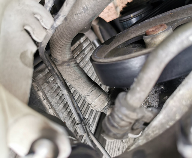

Highest priority mechanically wise is sorting out the whiny belt as I don't want that suddenly getting worse and self-destructing. I'm guessing it's one of the idler/tensioner rollers on the aux belt based on where it seems to be coming from and that the belt seems to be vibrating more than I'd typically have expected on a couple of the longer runs. Hopefully that's all it is rather than one of the actually driven components with a bearing on the way out as that would be annoying. Just realised that this might well be new enough to have a fancy freewheel clutch on the alternator too, which is something else I've never done battle with...
Looks like a set of at least low pressure power steering lines will be on that shopping list given how badly they're perishing.
The fluid also looks horrible so I'm wondering if it's ever been changed. Given that like brake fluid and manual gearbox oil it seems to be something that only ever gets replaced if there's a leak on about 98% of cars I'm going to guess the answer is "probably not."

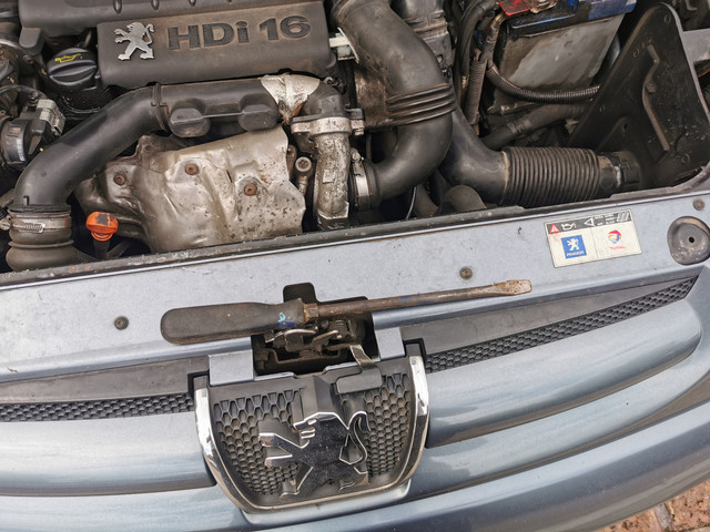

Is this the variant of this engine which is renowned for having issues with the strainer on the turbo oil feed inlet banjo clogging up? Given it looks to be easily accessible in this configuration, checking and cleaning that could definitely get added to the service regime. Have to admit to having near zero knowledge of the HDi engines in any form besides checking the oil on my father's Motability cars - all my diesel PSA vehicles have been XUD powered up to this point.

Yes, you have the engine that needs the oil pickup cleaned, and the injector clamps tightening every so often. Do that, change oil on time with the correct oil, it'll go forever. I'd be *very* surprised if it didn't return better economy than the VW, it's a great little engine when it's working properly. I'd regularly get 50+ from my 2.0HDi. The 1.6 is more modern and more powerful.

Oil strainer inside banjo bolt = yes that's the engine but no it's not easily accessible. The one you see top of the turbo is just a banjo bolt, the damned strainer is at the block end of that pipe and completely in accessible untill DPF and heat shield are removed. Not sure about the non-DPF variant but think heat shield likely still in the way??

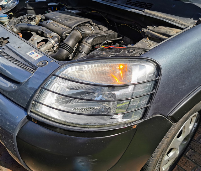

Nothing particularly meaningful been going on, but the Peugeot looks a good deal better having just given the exterior plastics a quick wipe down and the interior a really quick clean.
I feel like those chrome strips really don't belong on the rear bumper, but they are properly clipped in place. Guessing it's a replacement from an earlier model?
Taking off and repainting the guards on the lights is also on the list as they're a bit scabby in a couple of places. Was surprised to find they're actually metal - I was expecting them to be purely cosmetic bits of flimsy plastic.
Seats and some areas of the carpets still want going over with the wet vac, but it's generally looking a lot better.

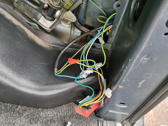

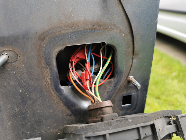

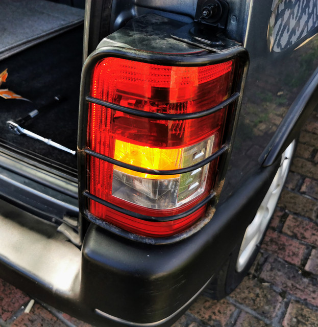

Really quick and simple job for the Peugeot ticked off today.
...My failure to take a "before" photo means you're a bit clueless as to what's going on there. I've changed the indicator bulbs as all four had turned almost completely white due to the coating flaking off the bulbs. The side/brake light bulbs were also very blackened so probably at the end of their lives - those were also changed while I was in there.
As you'll all be aware though there's an immutable law of the universe that says you can't ever complete a job this simple on a car without spawning at least one more task. So of course I found one.
Why is it that nobody in the history of the universe has ever done a tidy, professional job of wiring up the electrics to go with a tow bar?
What a mess.
I'll deal with that later.
It's actually all working (well the vehicle lights are anyway - I've no idea about the trailer socket) so I'm filing that under "Do Not Poke" for now and I'll sort it properly when I've got a bit more time on hand.
That offside cluster - or rather the guard on it - appears to be the cause of one of the rattles from the tailgate. The guard is actually touching the tailgate when it's closed. I'll see if a bit of carefully applied violence can gain me a bit of clearance when I go back in to sort out that wiring butchery.

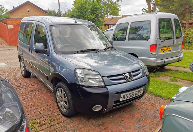

300 miles plus change done in the Peugeot today, mostly in horrific traffic thanks to the M1 being closed right about where the halfway point in my trip should have been. So traffic was absolutely horrendous both ways. Return trip was nearly four hours - should have been two plus change.
Observations: One. I'm extremely glad I sorted the squeaking clutch pedal, or that would have driven me insane. Two. The Partner is a bloody awesome thing for covering distance on any sort of road. Only thing it really wants for is cruise as she would far rather be doing 80 than 70 on the motorway. Used barely half a tank of fuel, so 500 miles on a tank looks to be entirely doable.
So what was so special I was willing to do a 300 mile round trip just to look at?
I'll tell you tomorrow if you can't guess. However it's always been a bucket list car for me, and suffice to say I was impressed with what I saw and have left a deposit. I now just need to arrange transport to get it home.
The car does run, drive and apparently stop - however hasn't been in regular use for Quite A While so will want to be properly recommissioned really before it does anything beyond a gentle bumble round the block at walking pace. So it will not be making the trip here under its own power. So I'm sending out a few messages to see if our usual suspects with regards to transport are likely to be in the area over the next week or so.
This does mean I'm officially DEFINITELY over capacity though until one moves on!
