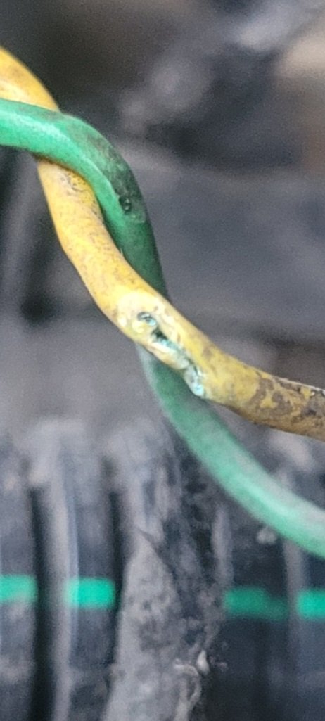

Could this be giving the car all these gremlins?
This is just as the cable trunking goes over the rear axle. My mext question is.... Where can I find this section of wire new?

Absolutely it can!
Well found. For these sorts of issues, Citroen just recommend an in-place repair. This looks like it has been rubbing and worn away the insulation. I would make a decent secure repair and then afterwards encase it in some of this protective tubing which can be had in various sizes that you can just pop over it to protect it.

If I had solder I'd have done it there and then. Going to grab the stuff needed tomorrow and make repairs. Fingers toes and everything else crossed.
I'll let you know. Thanks for the help.

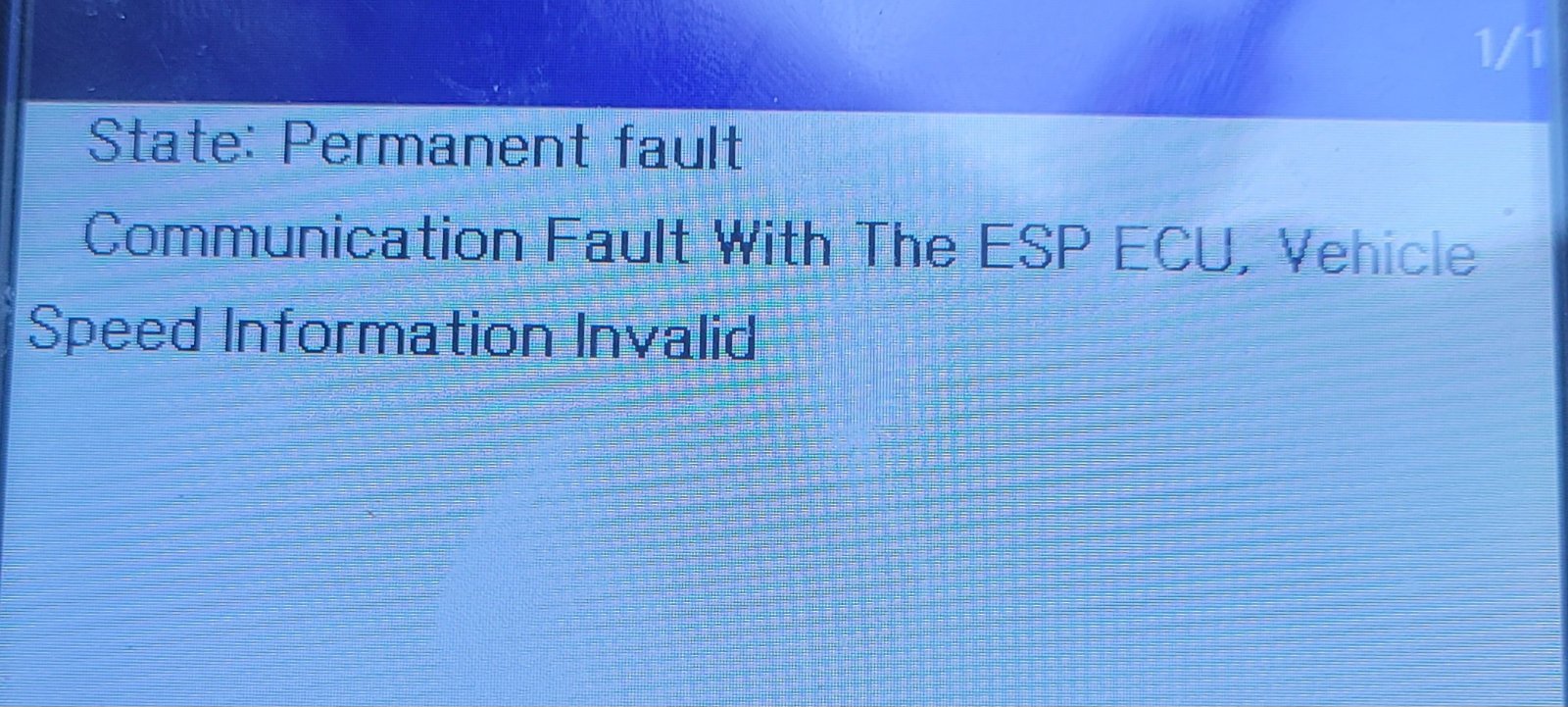

The ABS module still points to the rear right speed sensor and non confirmationof engine torque, with one difference. It comes up as a temporary fault that I can clear now. I wasn't able to before! (Picture attached)
The same with the comunication fault in the Engine ECU I am able to clear it, but not before the repair.

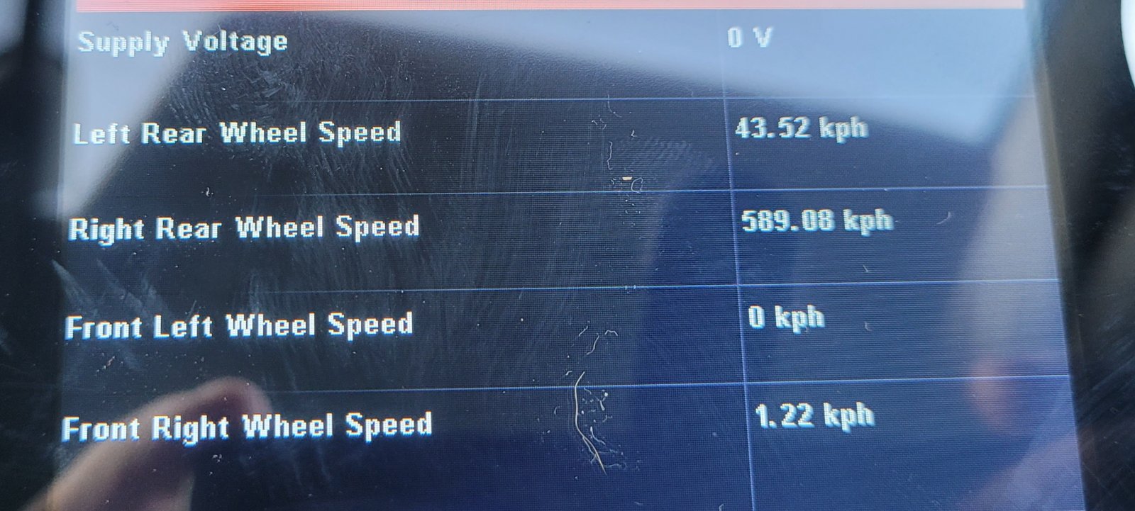

The sensors are still showing different speeds when stationary. (Picture attached)

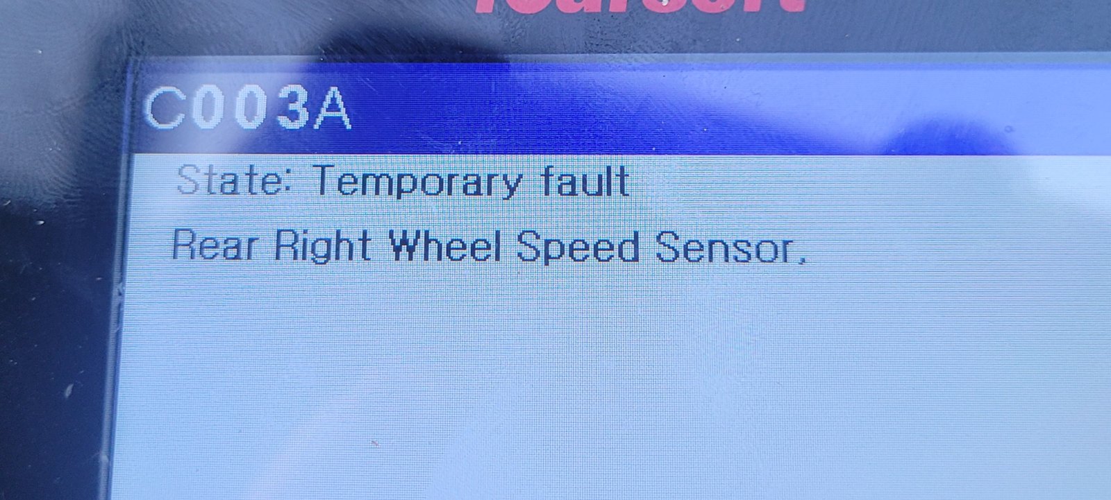

The diagnostic says for ABS. C003A. Rear right speed sensor. Temporary fault. C2391 Engine torque not cleared. Temporary fault. I can clear both these. I cannot clear the invalid speed information code in the steering ECU.

Unfortunately your diagnostic seems unable to provide the full fault code as there can be 8 possibilities of the C003A, identified by the missing last 2 alphanumeric characters (7 in total), so I can't give you specifics.
C003A 01 Rear right wheel speed sensor: Malfunction of the circuit
C003A 11 Rear right wheel speed sensor: Short circuit to earth
C003A 12 Rear right wheel speed sensor: Short circuit to positive
C003A 2F Rear right wheel speed sensor: Signal incorrect
C003A 62 Rear right wheel speed sensor: Lack of coherence of the signal
C003A 68 Rear right wheel speed sensor: Air gap problem (clogging)
C003A 95 Rear right wheel speed sensor: Non-coherent type of wheel speed sensor
C003A 96 Rear right wheel speed sensor: Internal fault
