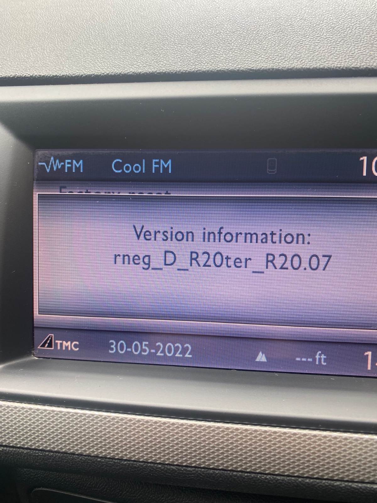

Recently purchased a 2009 Citroen c5 that has an sd card inserted in the front for maps navigation, unfortunately mine never came with the card so I can’t use the nav function, downs anyone know where to get maps from to put onto a card etc my version number is in the picture.

You have the 'MyWay' system. Maps are no longer officially available since 2018 second quarter..
