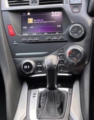

Hello. I'm just about to enter the world of DS5 ownership, all very exciting. I understand there were various different head units at different times, I wondered if someone here would know what unit it was from a blurry photo (attached)? Sorry, it's the best I have at the moment.
I've ordered it but haven't collected it yet, I'm looking at what sat nav update options there are. It's a 2016 DS-brand DS5 Prestige 2.0 HDi Auto Stop/Start. It doesn't have the dial and buttons by the handbrake that I've seen on earlier models, just a little sweetie tub instead.

It looks like the RT6 (eMyWay) unit, but to confirm, you'll need to post your VIN up (automasked on post sumbmission)

Wow, thanks for the quick reply. It is...
- x 6955
Re: What DS5 Head Unit is this?
Ok, so not the RT6, you have the digital connected nav with touchscreen - so likely a SMEG unit with mirror link.

If it helps, the buttons below the screen are DRIVE, NAV, MEDIA etc - not numbers 1-6 as I've seen on the earlier Citroen DS5s.
- x 6955
The numbers 1-6 would be for pre-set radio station on the vehicles with RT6 systems. You have touchscreen on yours, so these are selected via the screen.

Woooh! Is that a good thing? It sounds it to me anyway! Is the relevant info under your "Connected NAV" forum?GiveMeABreak wrote: 11 May 2022, 13:51 Ok, so not the RT6, you have the digital connected nav with touchscreen - so likely a SMEG unit with mirror link.
- x 6955
The DS5 stopped production years ago, so you have one of the last production models and they only had the earlier 7" Touchscreen units fitted. The latest units are completely different and fitted to a lot of the newer PSA vehicles. Watch out with Mirror Link though as it is is being dropped and has been by Samsung and others after later updates. So that Forum will be for the later units, but I'll still move this thread there now as I had moved it into the RT6 forum.

I just found a photo of another RHD one where the lengths of the button labels match the lengths of the blurred blobs on my photo. They seem to vary from LHD to RHD. I'm 90% sure they are (left to right)...
SETUP - WEB - TEL ------ MEDIA - NAV - DRIVE
