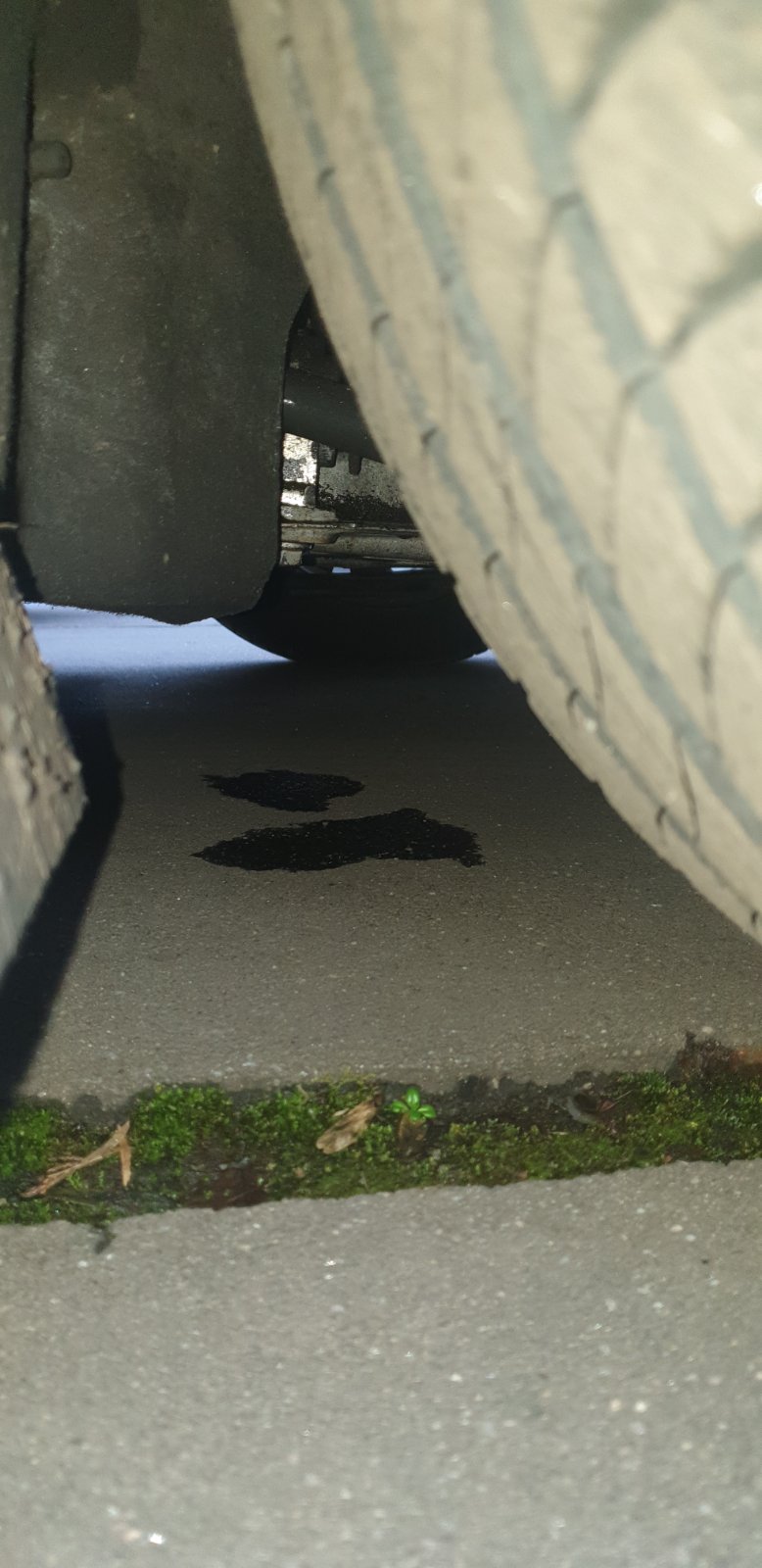

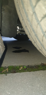

Re: C5 X7 Steering Rack - Again!
This is the overnight leak size. I think it might be more that 3" mind you that's overnight not 5 minutes
Graeme M
- Posts: 11774
- Joined: 02 Apr 2005, 16:11
- x 1240
Doesn't look too bad. I carry a litre of LDS with me but have never had to top it up when out or away, just check it now and again at home.

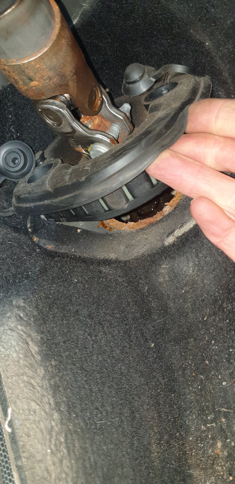

Looks like I'm officially in the club.
A little peak through the rubber bung and an oozing is seen....
