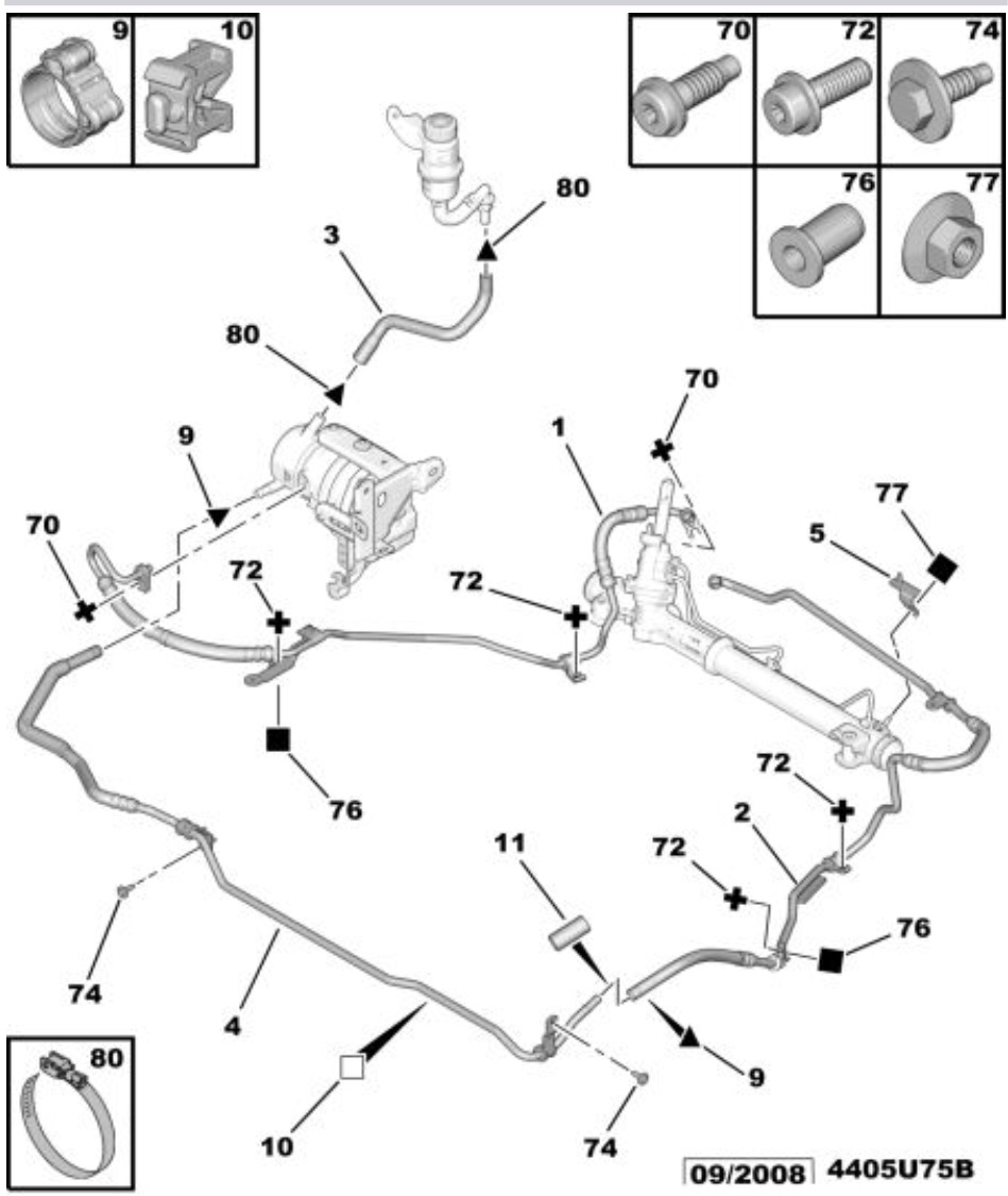

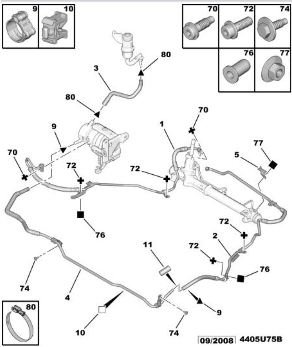

Re: C5 X7 Steering Rack - Again!
Yes I told them to grease it specifically. So you are referring to the low pressure pipe as in part (2) of the diagram that needs replacing?
