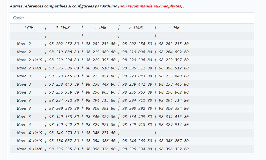

You can swap your RT6 with NAC. If you can get to the RT6 head unit and take it out, then you can fit the NAC yourself.
For that you'll need:
1: NAC EUR Wave2.
It can be Analogue (AM/FM): 9821908880 or Digital (AM/FM,DAB+): 9821908980. That one has additional orange antena connector on the back and if you buy that type, you'll obviously need additional DAB+ antenna (around 30€).
Or you can even fit a newer version: NAC Wave3 (9822305180) or similar (see the attathed NAC SN file) as Wave3 was fitted in the last two years of the production of previous 508.
You don't need dual LVDS version as that's only for iCocpit equipped cars. But it is important that the seller provides you with the VIN of the donor car (needed for telecoding or additional services).
2. Capacitive touchscreen: Your existing screen isn't good for NAC so you need a new one: Continental EMF DGT7C 9813041280, or Multitouch (3-finger gesture) 9825031680. That can come from any PSA car (mine is from Toyota Proace) as long as the SN is the same, but make sure it comes with the black LVDS cable with rounded connector to attacth it to the NAC.
The brown power connector to the screen becomes obsolete - new tochscreen takes the power and the data via single black LVDS cable.
3: Cable adapters from AliExpress (around 30€). RT6 and NAC use different connectors so you'll need adapetrs (in search type RCC NAC cable adapters). If you want to use the both USB ports on your NAC, take cable adapeters option C. Apple CarPlay and AndroidAuto will work nativelly, but only if a smartphone is attathed to original USB port, but you can use the second one for Mp3 stick or anuthing else.
4: Telecoding. If your NAC comes from a 2017 P508 then all it takes is telecoding the head unit to your VIN. But, it's a bit tricky with NAC as it's locked to the previous owner VIN, and you can't change that with your Diagbox (if you have one). Most of the sellers on the eBay have the Arduino tool and they will configure the NAC to your car (all the functions -if they differ- and write in your VIN) prior to sending it to you.
Upon installing everything will work Plug&Play and you'll even be able to use MyPeugeot mobile app (both for Android and iOS).
5: New front fascia (optional). With NAC installed your media knob on the central pillar will become inactive. You can take it out and install a small empty cup holder or a handy space for little objects, like it is on facelift models.
Also, some buttons under the touchscreen on the radio panel will become obsolete and therefore are removed in facelift version. But I think you can retain your original panel, just those Rev and Ffw buttons my be inactive...
6: Connected Services (optional). For NAC users PSA and TomTom offer a bundle of On-line services (real-time traffic on the route, wather forecast, speedcams and other). It requires 1 or 3 years subscription (89 or 149€). In order to use it you'll need to make an account on Peugeot Store Services site with donor car's VIN, buy the subscription with that VIN (as your original VIN isn't elegeble for Connected Services) and you'll need to establish a permanent Internet connection to NAC for that to work.
It can be done simply by sharing the Internet data from your smartphone, or you can go a step further and install an indipandent BTA2 telematic box that provides a permanent Internet connection with TomTom satelites. But that's a separate and quite a demanding topic...
Do some resaerch and when you have all the answers - you can do it youself. I'd say it takes moderate od medium DIY skill level. Definitelly not too hard to do (not a garage job)...
