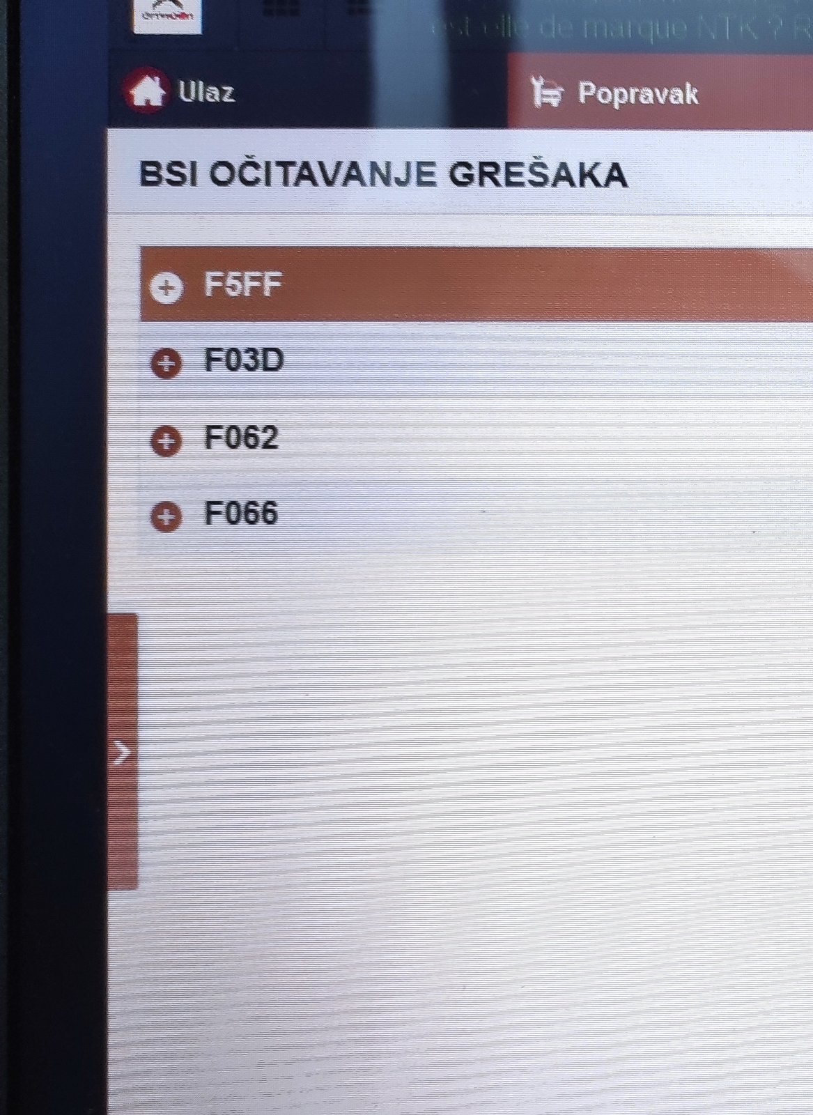

the parking sensors stopped working when I upgraded the software to 8.31. afterwards I attached Daigbox and saw that BSI has errors with the communication of the car radio and the phone, here are the error codes in the picture ...
Btw car is Citroen C5 2009

Re: Communication fault
Ignore F5FF for now.
F03D: means Absence of communication with the hands-free kit or the portable unit. So has this been wrongly configured / removed or activated when it is not installed?
Hands-free kit ECU or portable unit configured to "Present" but absent on the CAN
Hands-free kit ECU or portable unit configured to "Absent" in the built-in systems interface
No data received by the built-in systems interface originating from the hands-free kit or the portable unit on the CAN for 3 seconds.
F062: - Audio system ECU configured to "Absent" in the BSI.
- No reception of BSI data from the audio system ECU on the CAN (For at least 2,4 seconds)
F066: No communication on the network LIN (Between the BSI and the battery charge status control unit).
So for now I would be concerned about the last code F066. The Battery Charge Status Unit is attached to the negative lead of the battery. This unit monitors battery health and informs the BSI on the condition of the battery and determines when the vehicle goes into economy mode.
Have you altered anything here or done anything to this unit? It is important that this is working and configured correctly.
One of the causes of this is incorrect configuration in the BSI.
I suspect given these errors, that some settings in the the BSI has been changed without knowing what the consequences are of doing so. Not everything is obvious and some settings need to be a certain way (even if they look wrong) for certain vehicles with certain optional equipment to work properly.

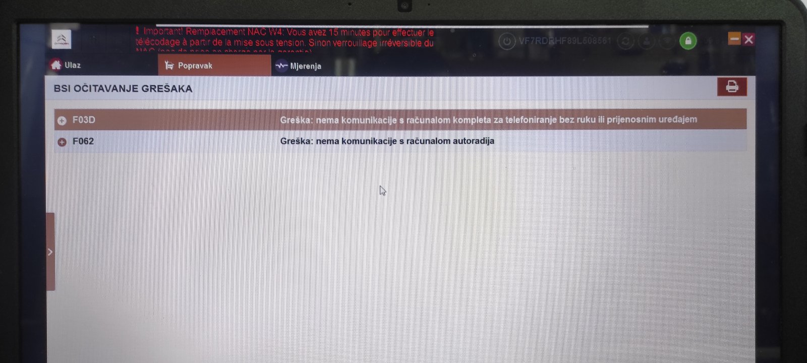

Hello again,
how can I solve the problem with the communication of the car radio RT3 ev and the multifunction screen with BSI?!
thanks...
