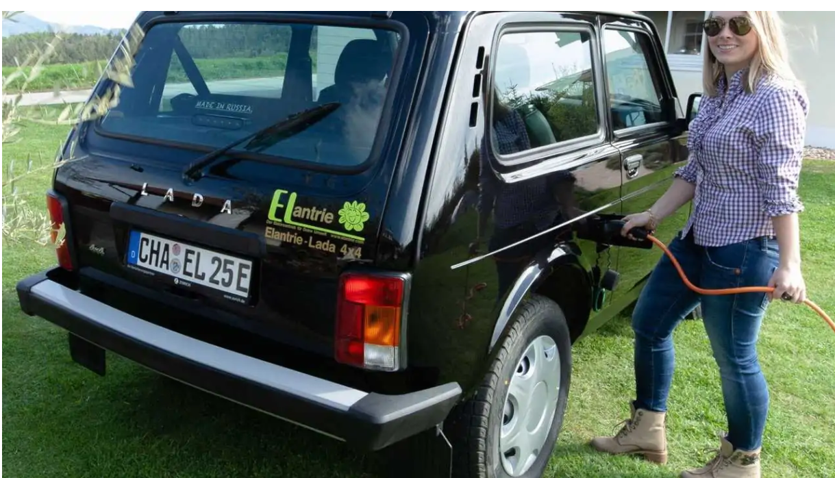

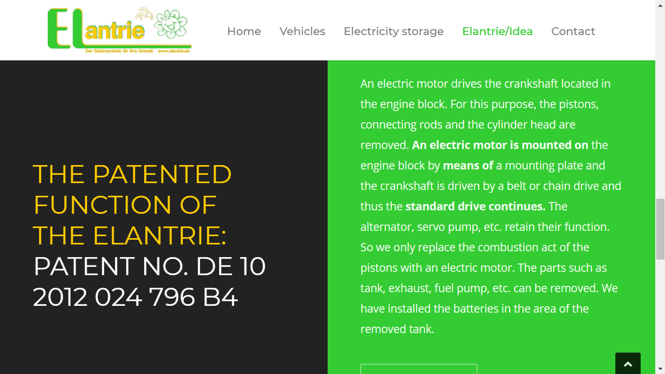

Never come across this approach to conversion before. This firm in Germany have patented it.
The site is in German and the idea seems bonkers, but they have done it to a few cars including a Lada Niva
2,800 euros, not sure if it includes the The LiFePO4 batteries used in the Elantrie system.
LiFePO4 is having a bit of a revival being safe and reliable if not as energy dense as some other chemistries.
translated from GermanThe idea
Our idea was and is to develop a cost-effective electric drive for the so-called second car, which completes its services in the daily short-haul range. So the drive to work or shopping etc. There are over 20 million registered small and medium-sized cars in Germany. We think that with the elantry system in this sector we are in good hands to achieve our goals here.
The affordable idea also plays a role here, that with a manageable investment for a constantly reusable elantrie drive (the drive is offered in a wide variety of car model series)

My mate and I came up with a very similar idea 2 years ago. The only difference was that we were going to dump the crankshaft and replace it with a straight shaft going through the motor and out to the transmission. We thought driving the existing crankshaft wirh a chain was simply asking the motor to turn over more metal mass than is necessary, so we intended to remove the head, block and contents and insert the motor in the crankcase with direct shaft to the transmission, manual or auto. I have sketches of our plan somewhere but not sure where!!

So the plan was to use the bare crankcase as the mounting frame for the electric motor, yes?

Yes, basically to replace the engine's innards with a single straight through shaft with commutator and armatures attached and then fix the magnets around it inside the crankcase! We have never progressed it beyond the sketch stage due to various domestic distractions!

So the main bearings are the shaft supports and the armatures fit in the crank throws. Neat solution and not as daft as it sounds. The overall concept is sound to my thinking. Would you have retained the clutch?

Yes in the case of a manual. My thinking was to keep all the transmission as it was in whatever vehicle was converted. Simply change the method of rotating the crankshaft by using the crank spaces as you say. With the main bearings supporting the new straight motor spindle. I got the idea from looking at the induction retardation systems fitted to coaches back in the day! It just seemed to me that the whole process could be made to fit in most inline ice cars and fit batteries where the fuel tank had been and wherever else was available in the car. Main cost would be having the shaft machined and building the armatures etc. We may get round to pursuing it further one day!!

I can't understand the thinking, surely you chuck the engine out altogether and mount the electric motor direct to the bell housing.

I see how the retarder would have spiked your thoughts. A shaft replacement in a huge heatsink with the potential for liquid cooling - how much would that cost to re-engineer. Even the bores are useful conduits for wiring and cooling.

Far too easy GibboGibbo2286 wrote: 20 Aug 2021, 09:31 I can't understand the thinking, surely you chuck the engine out altogether and mount the electric motor direct to the bell housing.![]()

At the time we hadn't got round to thinking about cooling so nothing to add there. As for the wiring our ideas were along the lines of pvc conduit feeds for the motor and the controls but we didn't get as far as planning it. Fundamentally our main issue that we couldn't resolve was the cost of batteries and that put the whole project onto the back burner, or maybe even into the freezer!!Dormouse wrote: 20 Aug 2021, 09:51 I see how the retarder would have spiked your thoughts. A shaft replacement in a huge heatsink with the potential for liquid cooling - how much would that cost to re-engineer. Even the bores are useful conduits for wiring and cooling.
