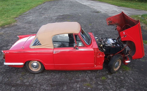

Another Triumph for the collection, the electric herald by DragonEV featured in a Telegraph article from 2013
http://www.telegraph.co.uk/motoring/gre ... power.html
THE FACTS Dragon Electric Herald
Netgain 25kW continuously rated motor, capable of 300kW peak power (about 400bhp)
Top speed: 75mph
Maximum range: 50 miles (up to 150 miles with lithium-ion batteries)
Clutch: none – direct drive to propshaft
Gearbox: none – sufficient torque from electric motor. Reverse provided by changing polarity
Ignition: none – just an on/off switch, press the pedal and go
Power output: 60bhp (capable of upgrade to over 200bhp)
Torque: 150lb ft approx
Battery voltage: 72v
Battery capacity: 15kWh
Controller output: 600A maximum
