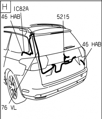

Don't get hung up on the colours as these can be random and non-specific. Stick to the wiring numbers printed on hte sleeve every 6 inches or so, but more importantly the pin numbers:
There are 3 pins on the motor wiring plug:
Pin 1: Wire 521: Rear windscreen wiper motor command
Pin 2: Wire 522: Rear wiper motor fixed stop control
Pin 3: M5215: Earth
Back to the rear wiper. These are controlled by the BSI now and the relays are integral to it and are not really user serviceable. These are rarely the issue - it is more likey to be the motor or a wiring break I suspect.
Pin 3: M5215: Earth

If I put 12V+ on the pink wire the rear wiper starts and works, so the motor's ok.
I traced this wire, using your diagram back to the connector on the rear left below the side window, where pink, turns into grey (you're right about the colours!). At no point does this wire get a 12V+, whatever the switch is doing and the earth is good.
I even bypassed that wire, by feeding a new one through from the connector itself to the motor, just to be sure - nothing.
