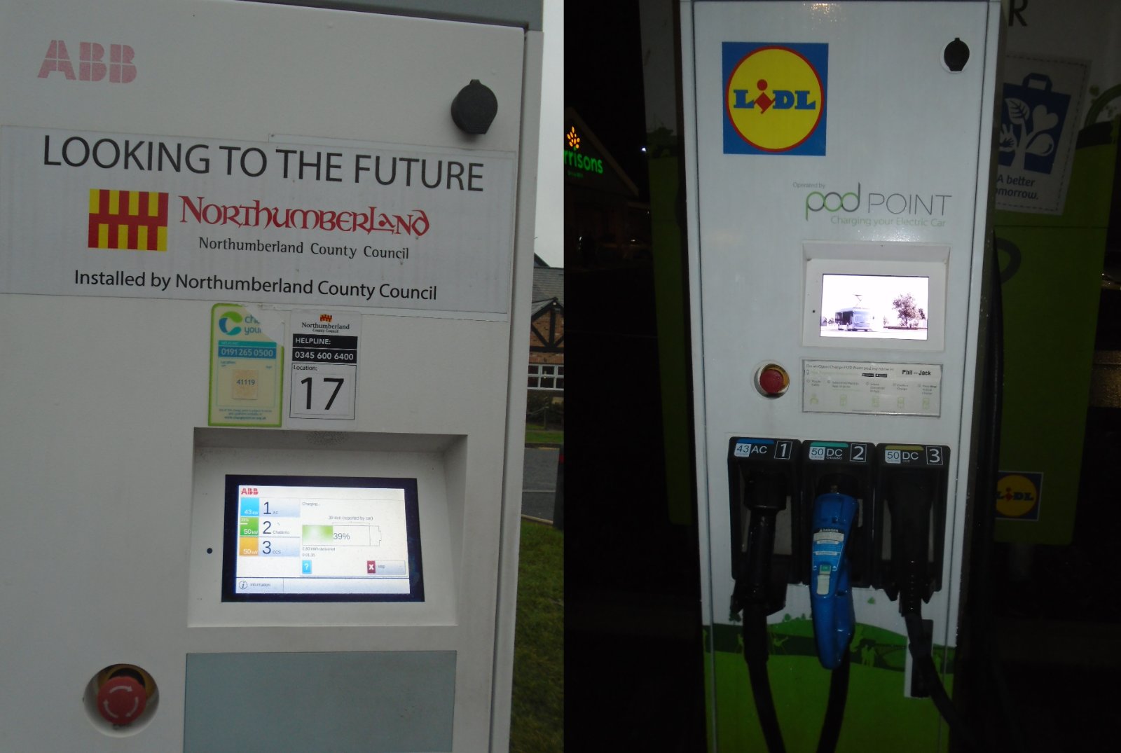

A Tale of Two Chargers.
The NCC rapid chargers dotted at several locations throughout the county are currently free to use, and have the Chademo rapid charger I need for the Leaf.
LIdl have chargers at many of their stores, their partners are Pod Point for which currently you need to be in the Pod Point "club", and have the Pod Point app, and no way of paying at the charger with a bankcard.
