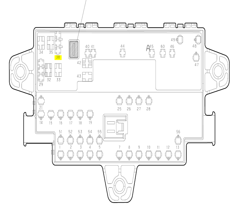

Ok, so this was the issue on earlier models:
Fault concerns the 'central locking and window mechanism do not function'.
It is casued by Fuse F38 (20Amp) in the engine fusebox burning out. This is caused by the interior roller of the switch supply wiring harness getting fouled when the side door is closed.
The harness should be isolated and moved / secured away from the curved part of the rail and then fit another 20A fuse. I would check the wiring whilst you are at it and make any repairs.
Fuse F38 should be located in the engine fuse box highlighted in yellow below. You'll have to click to zoom the image.

- Posts: 29
- Joined: 20 Oct 2019, 14:38
- x 2
Re: Citroen Relay CDL and Electric window problems.
Thanks Marc, just to confirm this is the fusebox under the bonnet? Am thrown by the A on it as fuse box A I thought was the one on the passenger side next to the glove box.
