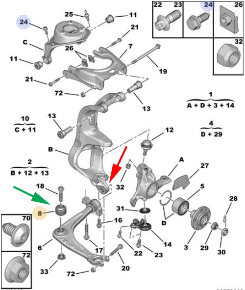

Hi to all,
I need to replace Lower Rear bush on front suspension arm wishbone on my C5.
Does one of you did it by yourself?
Is it possible to do this without removing the complete wishbone out ??
So just unscrew two screws that hold the Lower Rear bush, remove it and put a new one ??
The car is with H3 +, and the bush is on the picture (not exactly like this one), I have wishbone 3520X6 3521T7.
Thanks

The rear bush on earlier cars and I'm told your series was a press fit on the suspension arm which obviously requires removal of the arm also importantly the radial angle at which the bush is pressed on is critical for long life, This angle I guess is that which the arm assumes at normal ride height.
It is not a very difficult job all one needs apart from normal tools is access to a press or a friendly engineering shop.

Ok, so if it's number 8 on the diagram that I've marked in Green, then it's part number: 3523AQ, (Front Triangle-Arm Wishbone Bush). These are £20.69 available direct from Citroen inc. VAT.
However, if it's the one marked by the red arrow, mine too recently went and Citroen do not supply the bush on its own, hence there is no part number. However, you can get the bush cheaply enough from motor factors.
Here is a link to one seller on the bay:
https://www.ebay.co.uk/itm/221738423630
I got mine from a motor factor supplier and my mechanics replaced it easily enough.

no man it neither its number 16 by the look of the drawing citroen dont sell them either so it very hard to cross reference

ya that's the part but i have no problem in getting them in a dozen places only they are differences are the ones for the hyrdo suspension the same or different

The C5 X7 uses the same pivot and hub system whether Hydraulic or metallic sprung. There are different wishbone part numbers whether the steel or ally subframe and from different build dates. but as the bush is not available for this area separately from Citroen, I can't help you - but the wishbone for the left is part 3521S4 or 9663980680 for the right one.
The link I specified does list this part number in their listing - so you should be covered.
