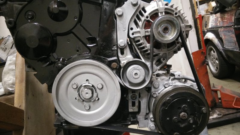

Anyhow I got my compressor bracket fitted:
