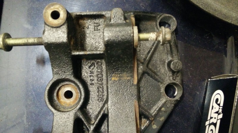

Guess what I am finishing my engine and so I want to add the compressor already due space and the bracket holding the A/C compressor doesn't fit.
So there is a difference between steel and aluminium crankcase?
Another question is how to add the belt tensioner?
AX fitting airco system

Re: AX fitting airco system
Cars with A/C I think always had the aluminium sump to bolt the compressor to. I think that the alternator bracket and tensioner were also different with A/C fitted.
Thanks for the reply,
Alternator bracket are for both the same with A/C.
steel crankcase had a different mounting A/C bracket.
Just did some research on service.citroen

Anyhow I got my compressor bracket fitted:
