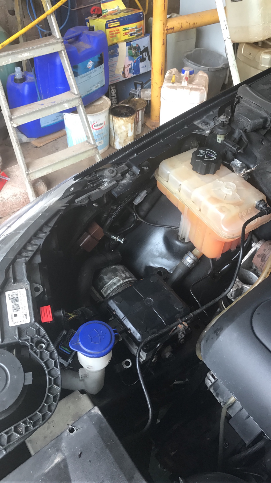

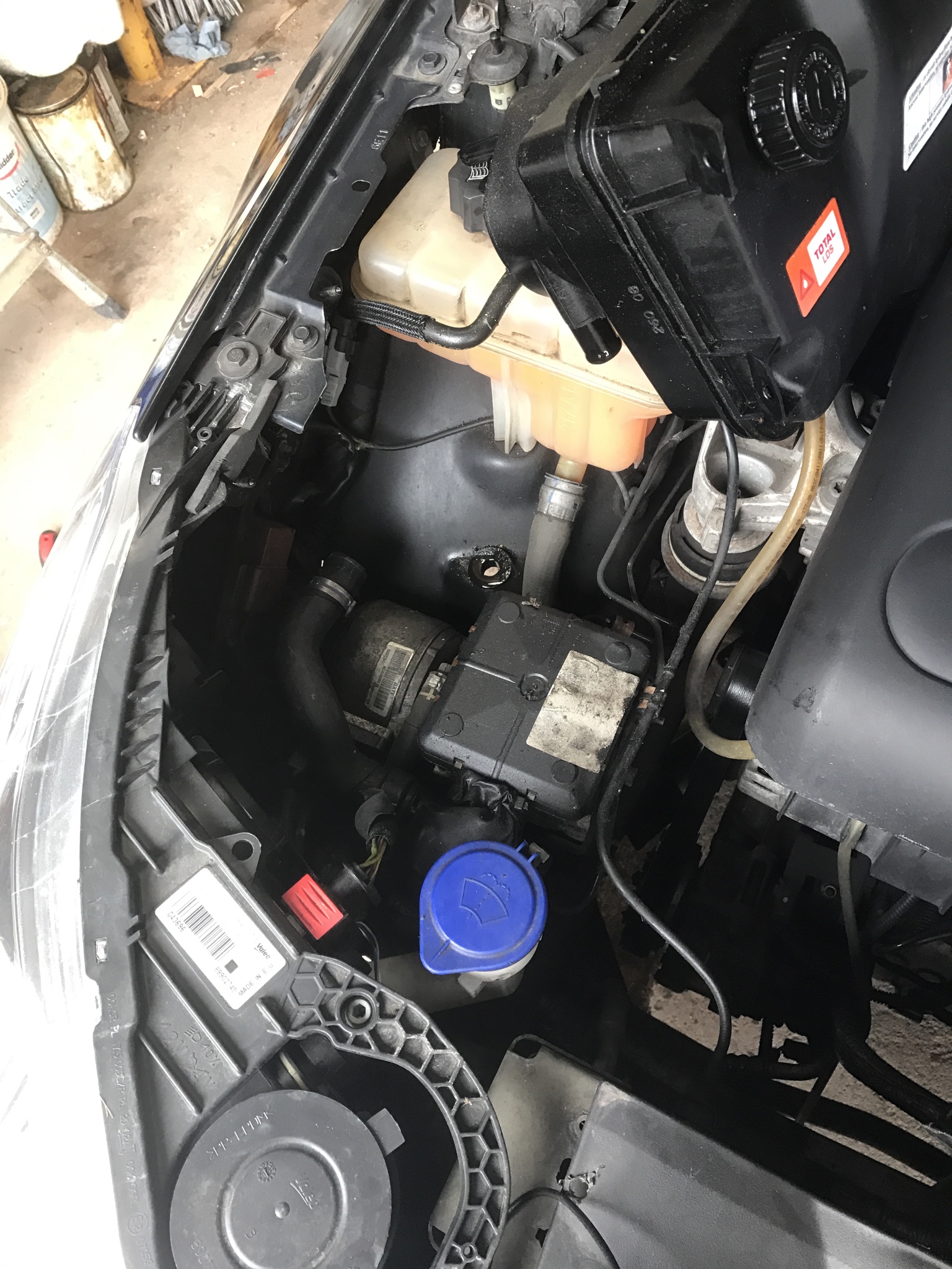

The first step was to remove the LDS reservoir.

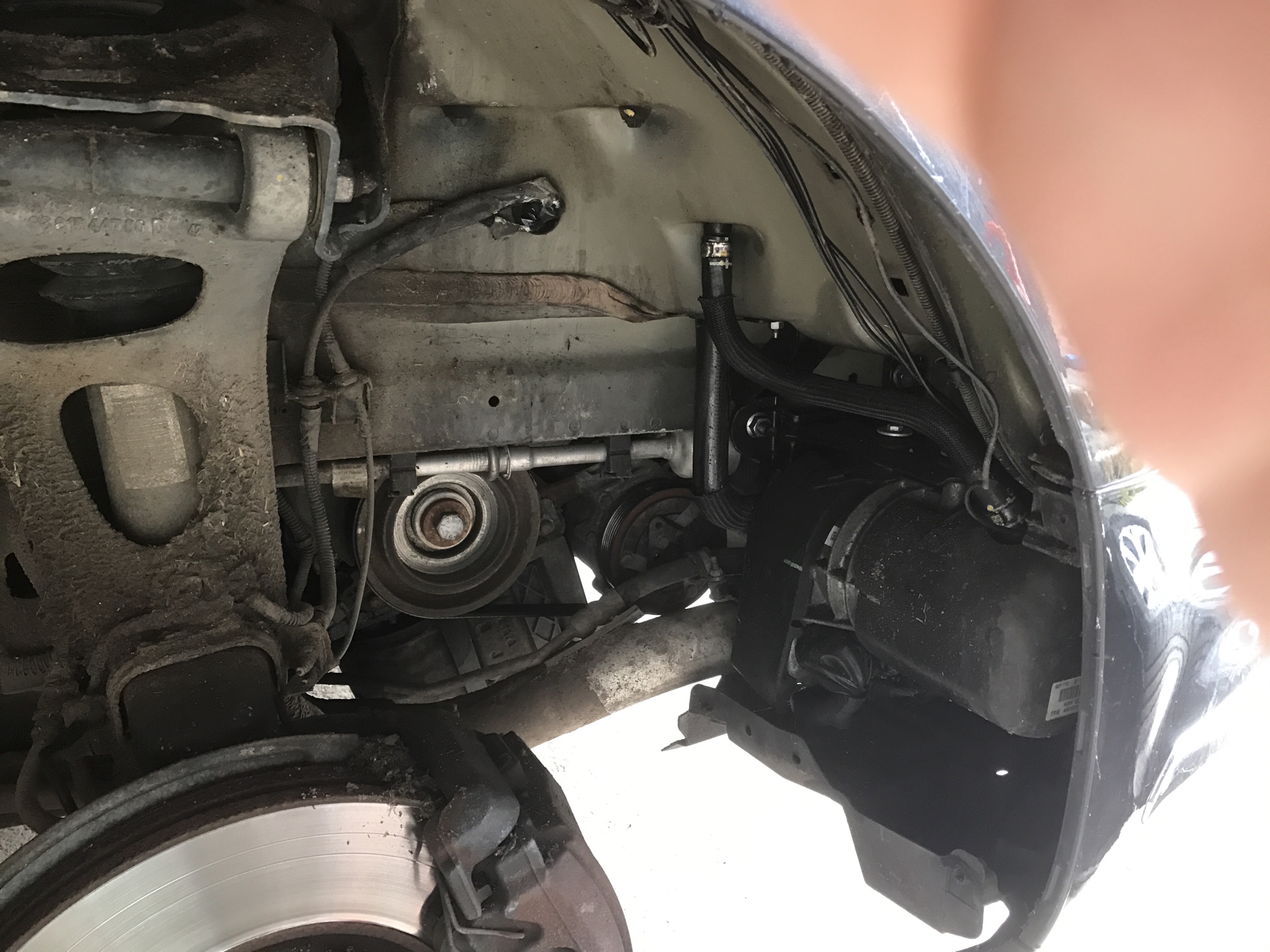

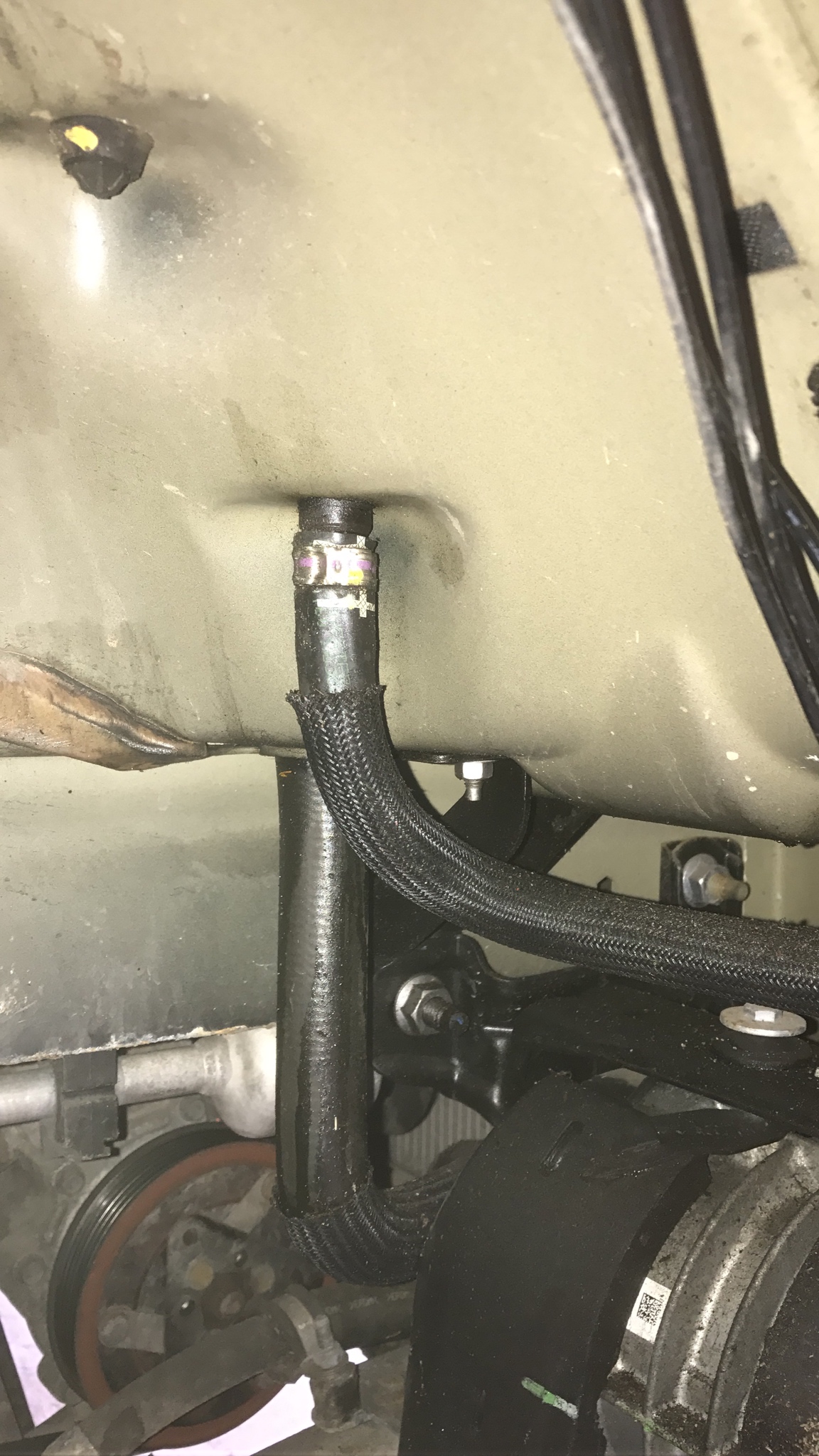

The wheel arch liner on the drivers side is removed exposing the Powered Steering pump and it's feed from the LDS tank that pokes through the inner wing:
Close-Up of the Powered steering feed pipe:
After the PS pump's pipe is removed the LDS pump feed pipe can be removed. After undoing the two flanged nuts on top of the LDS tank it can be lifted clear out of the way of the pump:

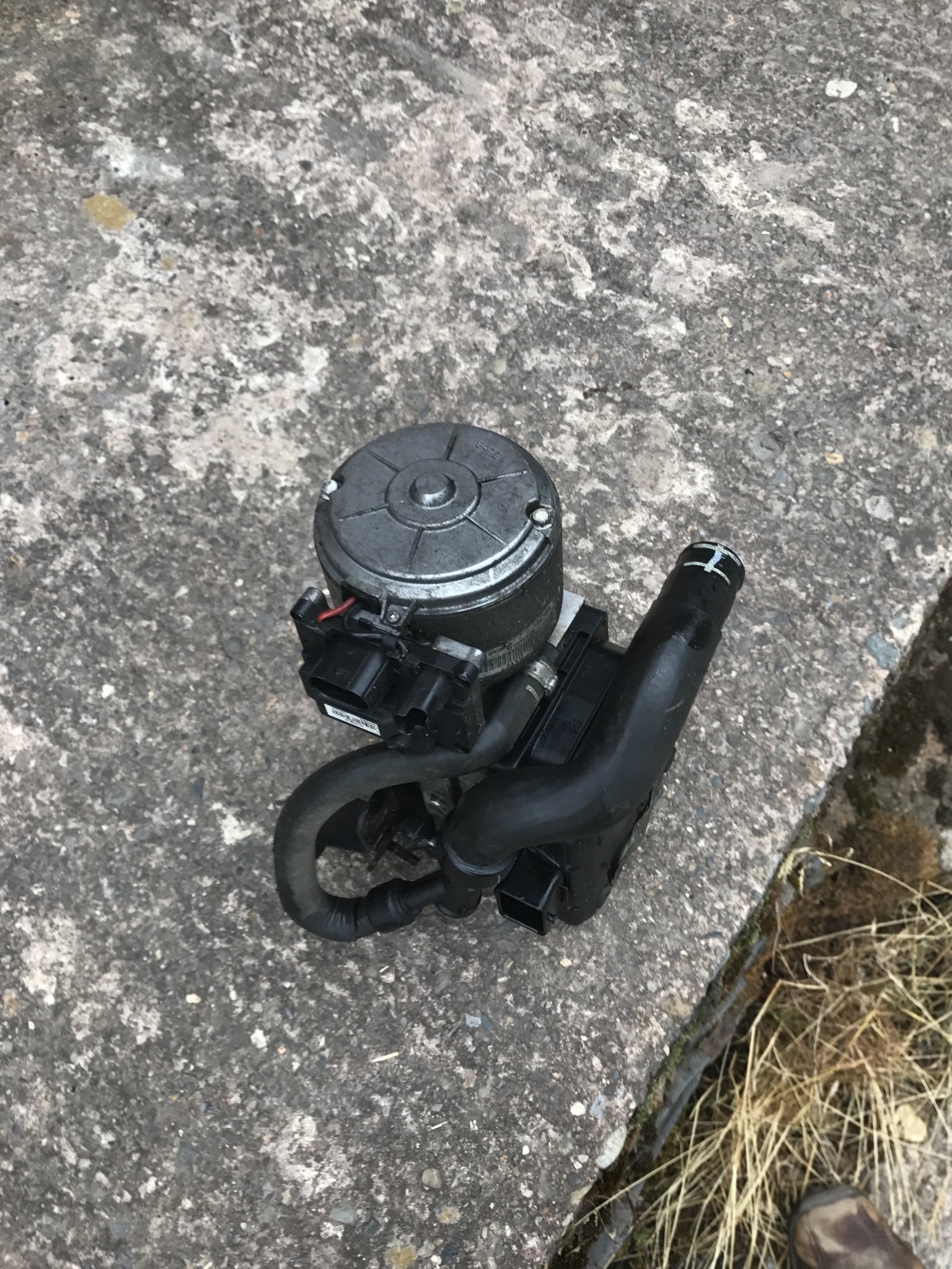

After disconnecting the two visible 10mm bolts from the inside wing and removing the two 10mm nuts from the wheel-arch the pump can be lifted out (once the electrical connections are disconnected.
Pump removed:

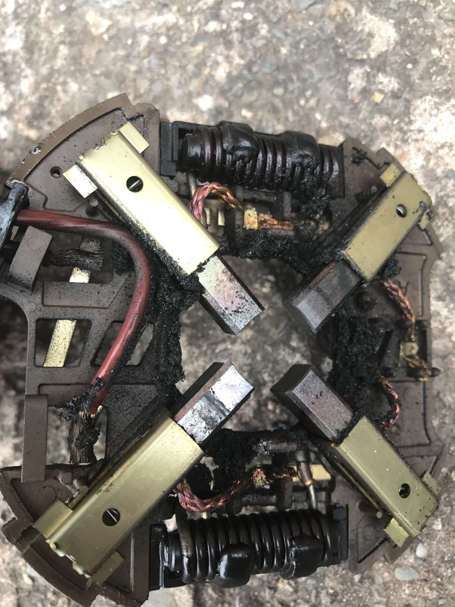

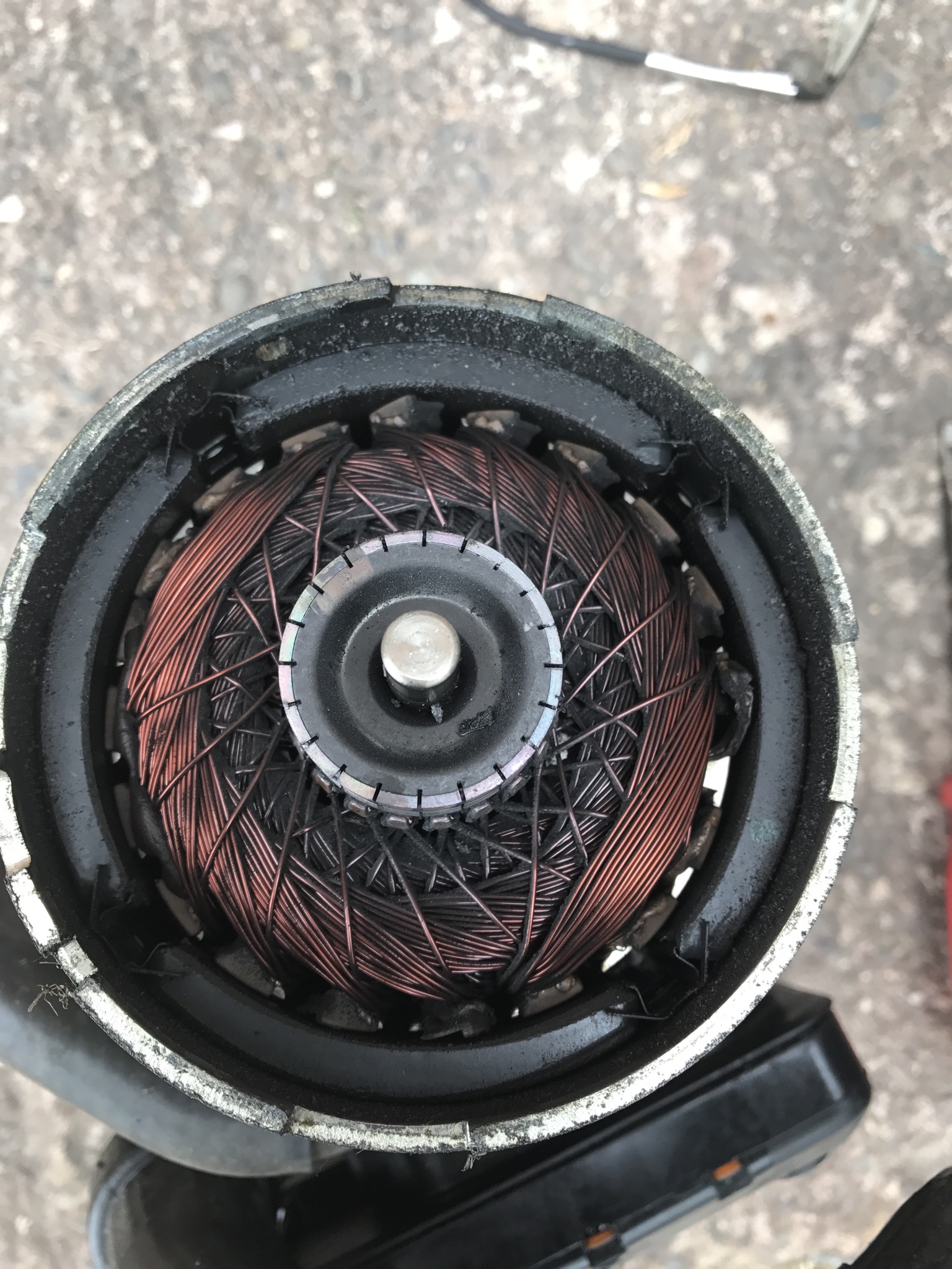

After removing the end cap of the electric motor, the black filth is immediately visible:
Lots of conductive carbon paste everywhere:
The windings also looked dirty:

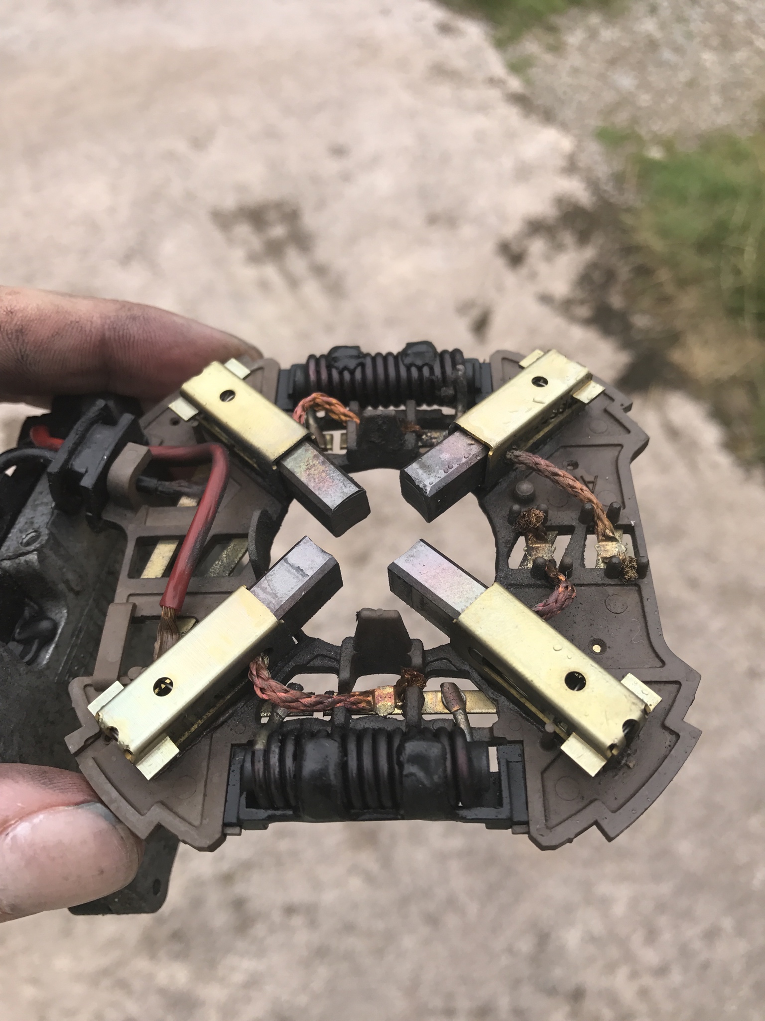

From this angle we can see the odd wear of the motor brushes, there's a lip on it. Not sure why this has happened:
Now I set about cleaning the brushes and motor housing. Using a mixture of brake cleaner and compressed air. I also filed down the lip on the motor brush so it was nice and flush:

If you look at picture No 7 ( the ‘lip’ on the motor brushes), it looks like 2 opposing ones both have a lip. Is this not intentional to keep the winding ring in place? It just seems odd that 2 opposite ones have the lip and the other 2 don’t.....
I think I’ll see if I can locate another one for comparison.
x 6958
Re: C5 (X7) Suspension Pump Motor service (removal and cleaning)

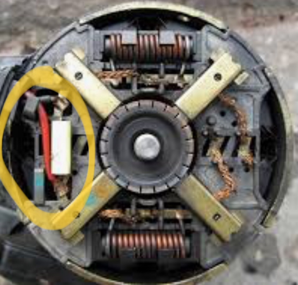

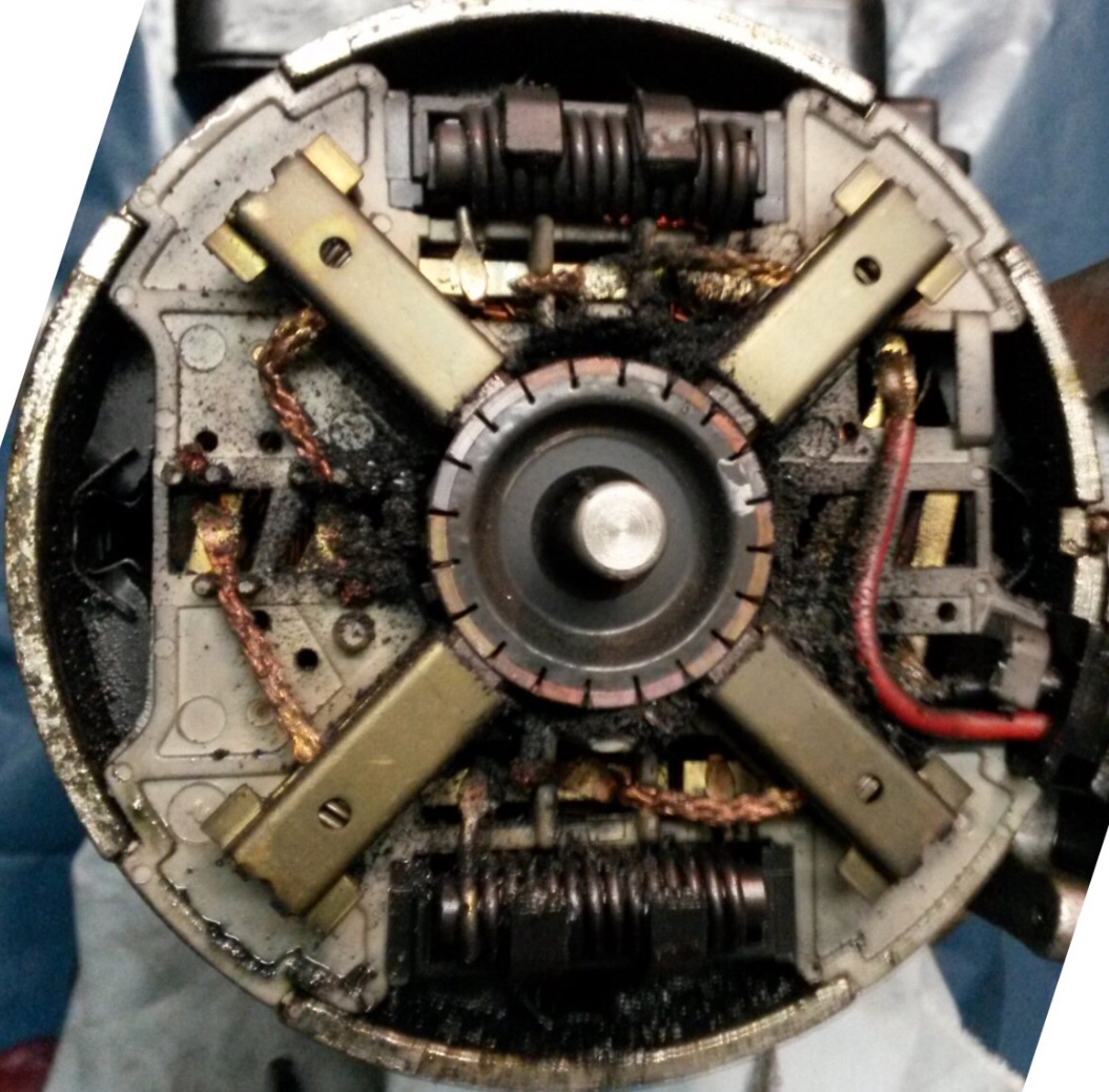

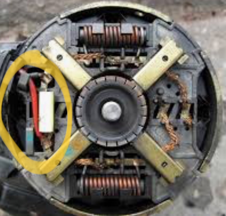

The difficulty is trying to locate pictures of C5 X7 motors as these are different to earlier C5 versions. On earlier ones, you can see a white capacitor, whereas the X7 and C6 versions don’t.
So assuming the C6 version is the same as an X7, it would appear that there is no lip then Elis, so maybe they were not balanced and wore through the ends of 2 of them???
Earlier C5 Brush showing Capacitor that can fail (circled)The later version on a C6 and possibly the X7

That's a very interesting point. I think perhaps the brown plate that has the brush holders on is slightly bent; aiming two of the brushes a bit too high.
I'm not sure if the lip on the brush would cause an issue eventually but I'm certain it was the carbon dust in this case.

Marc are you sure the white thing is a capacitor? It looks just like a wire wound resistor.
That brush wear (with the lip) won't be by design, it's either poor manufacturing tolerances causing the brush to ride up, or poor initial assembly causing uneven wear.
With no ventilation, there is no chance for the carbon dust to be blown out and since they've probably used cheap (poor quality) Chinese carbon brushes in these later models, the dust problem will be exacerbated.

Whoops, I typed 'Capacity' in the table on my last post Iain - blame it on the ipad keyboard! It is referred to as a capacitor, not a resistor that can fail on previous C5s from what I can tell.=, but there isn't any documentation that refers to the 'internals' unfortunately. But it could well be a resistor if others are confused too!
x 1750
Looks like a high-wattage ceramic bodied resistor, possibly to limit current surge when motor starts?

That component is fairly clearly connected across the supply leads, which would be an odd place to put a resistor. A capacitor would be much more sensible, considering the inductors in series with the brushes furthest from the input wires. The component looks rather like a polyester capacitor to me.
x 1750
If across the supply wires, likely an R-C suppressor.
Those inductors are hefty things.

It's definitely a capacitor on the pumps fitted to the earlier C5, not sure why they are omitted on the X7s.

That's what I thought, I've never seen motor brushes worn like that. It's a bit late to do anything about the alignment of the brush holders now as it's all reassembled :x

On the peculiar wear-step on the brushes, is it possible they started out ok, but have shortened with wear, were not kept as horizontal as they should be? Just a guess.
x 6958
That seems to be the case Chris, as I have looked without success, for any similar 'worn' ones. It just seemed odd that is was the 2 opposing ones that were worn. :-k

Perhaps it was a production issue as wurlycorner suggests or maybe the whole plastic assembly has got hot at some point and distorted. I feel like the brush assembly should be more rigid but it is what it is unfortunately.

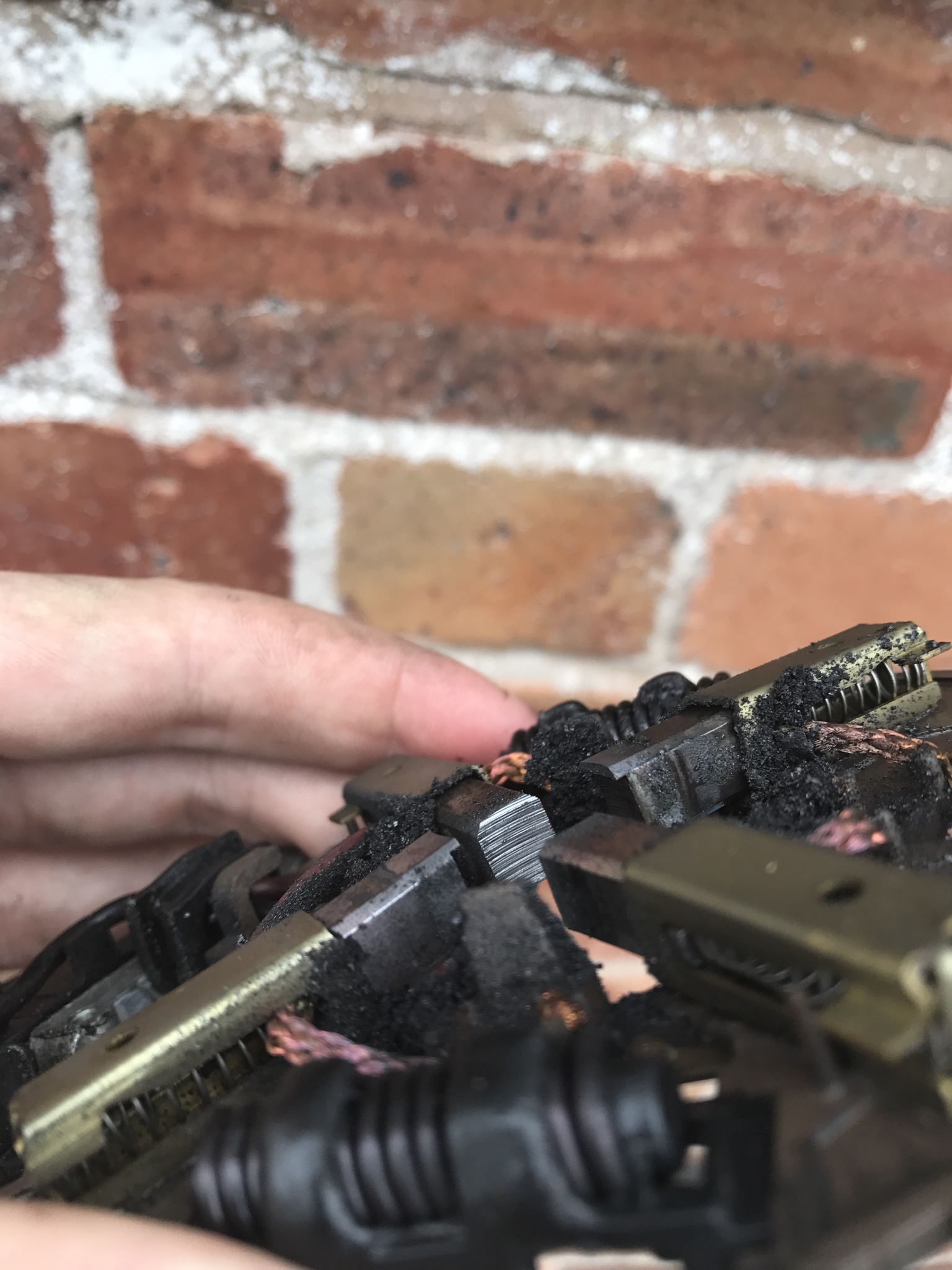

Could be the plastic brush baseplate having distorted.
Looking at your photo #6, it does look as if the brushes have a very loose fit vertically in their brass guides. Seems to be a sizeable gap above the brushes, and this is filled with brush debris. Or are those brass tubes lined with something, which would be unusual?
Brushes should be a decent fit in this type of motor, ie they should slide freely in their holders, without sticking and without slop.
Could incorrect brushes have been fitted, maybe at factory?
Plenty of companies specialising in motor brush stock/supply. All you need is some accurate dimensions (length not critical; can be reduced if necessary).
If slightly too tight a fit, stroking the brush on a dead flat bit of emery paper will ease it.
