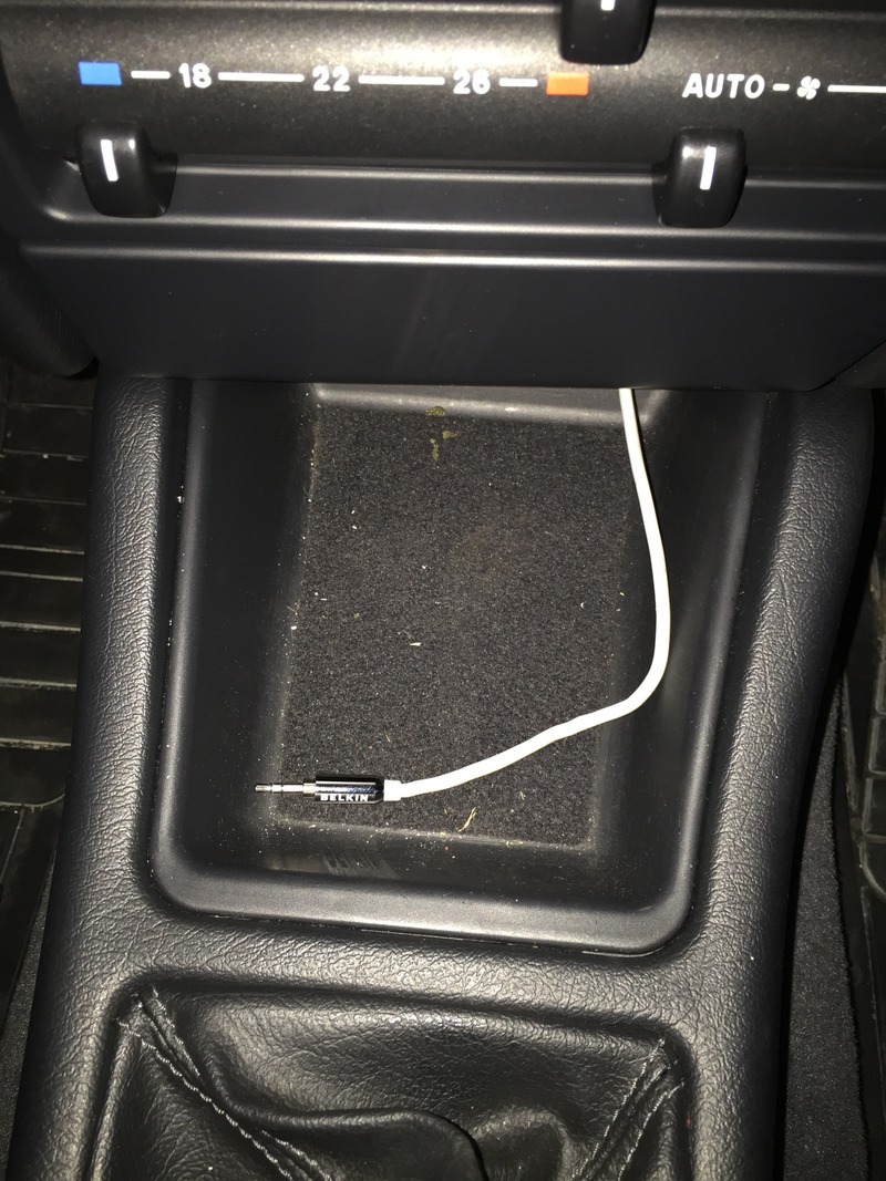

Just to give this another bump for others to see... I decided that tonight I'd modify the Activa radio from having a functioning tape deck which I've never used to having a working 3.5mm input for my iPod to connect to as I wanted it done for the trip to the Northern in a few weeks.
Once it's done all you can see is the tail of the wire sitting in the little storage pocket in front of the gear lever...
On all of the conversions I've done I've used one of these Belkin Cables...
http://www.ebay.co.uk/itm/251695500476? ... 26_rdc%3D1" onclick="window.open(this.href);return false;
If you cut the cable exactly in half there's more then enough of it to feed into the storage compartment on the Xantia. It's probably a bit too long but you can push it back through into the dashboard.

I've found those cheap tape adapters with a 3.5mm input work ok if you fiddle with the internal gears a bit to make them spin freely. Either that, or on our S1 Xantiae the stereos have an aux input anyway, so we just use a 3.5 male-male lead between phone and stereo... Newer is not always better ;)
