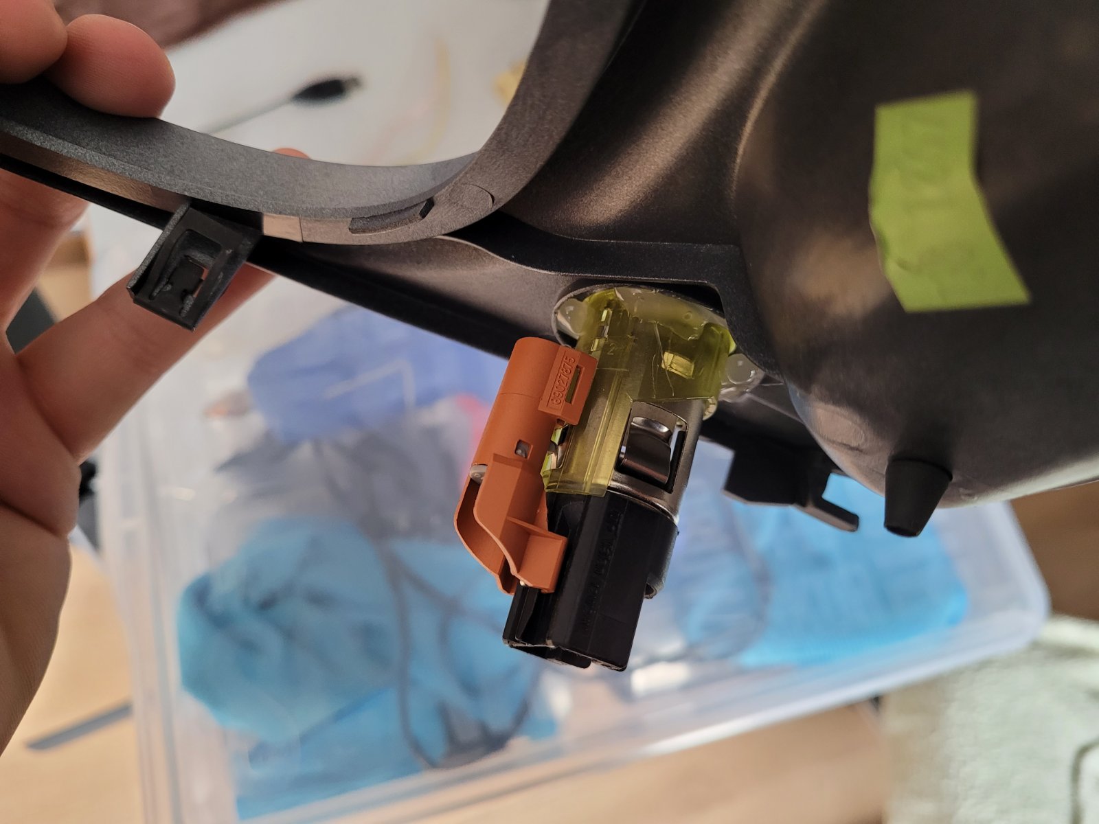

Thank you! I just changed mine. For the cigarette lighter, that one is not easy. It's a maroon socket that is pretty hard to detach and you run the risk of breaking it if it's cold. This one is from my small mod to add a secondary, surface mounted socket so I can use my large phone charger in the front.
Bulb socket
Bulb socket
