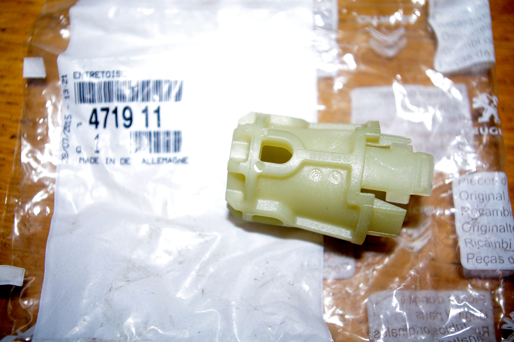

I had a similar problem two years ago with the MOT examiner saying that a part in the rear section of the handbrake cable on my 09 Tourer was starting to break up. He passed it because the handbrake still worked ok! When I had a look I could see that the spacer on the LH rear caliper - item 4 on the Citroen Service diagram - was actually broken in the middle but both ends were still on the cable. If one or both sections had disintegrated completely and fallen off, the spacing function would obviously have been completely lost and the inner cable would have become loose in the outer with consequent loss of function. As it was, I was able to araldite the two halves together and reseat the spacer. Two years on it is still ok. However, as a precaution, I did get two new spacers from the local Citroen dealer to fit if needed. Must be the cheapest items ever from Chez Citroen - £2.95 the pair, part number 471911.
If your spacers are starting to crack up maybe that could explain the loss of efficiency in your handbrake

Ok Marc,it's not a big job to check the cable spacer on the EPB. As I said I haven't actually replaced mine, but I've just had a quick look and should only take 10mins.
Procedure to inspect and replace EPB spacer C5 x7
1) Suspension to high ( hydractive model)
2) Chock front of car
3) Jack up and remove rear road wheel
4) Handbrake to off - Ignition on
- Foot on brake pedal
- Hand brake switch down
- Ignition off
Handbrake should stay off
5) Inspect spacer (see photo) - also convoluted protective rubber cable cover - mine is shredding
6) For closer inspection and removal of spacer pull cable inner off brake actuating arm, then pull inner and outer cable out of arm from front of car - spacer can then be replaced if needed. Ensure that the spacer seats correctly in the arm.
7) Cable back onto arm etc.......
8) Check operation of EPB.
There may be nothing wrong with yours but at less than £3 to replace both spacers rather than £780 plus fitting for a new EPB it's surely worth a look.
