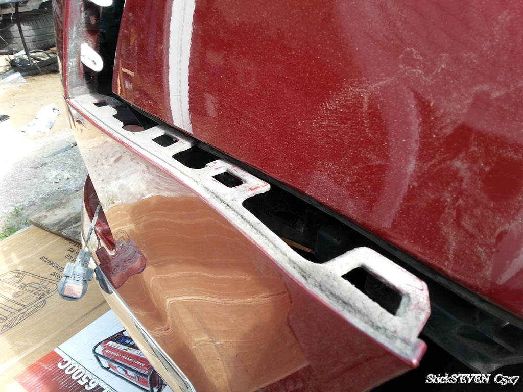

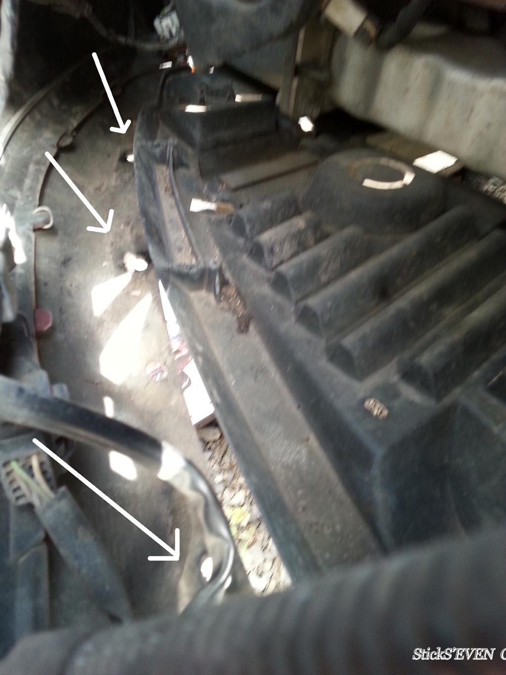

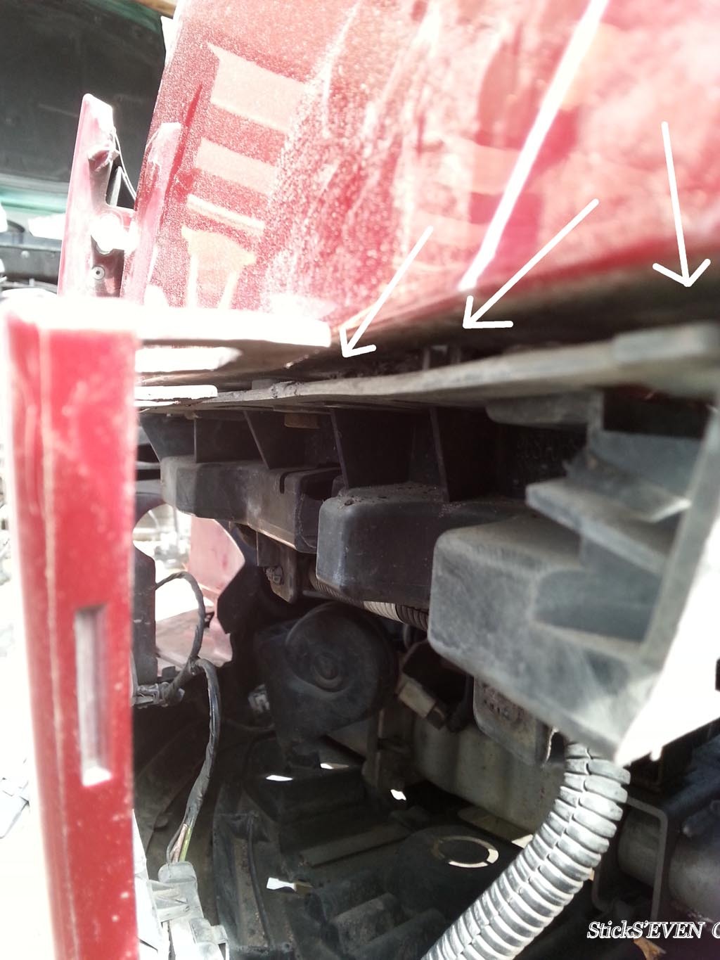

OK....so I started trying to work it all out concentrating on no distorting plastic of ripping out lips or lugs......this is what I found.
removed wheel arch screws (x2) each side, and pulled back the liner
6x screws on the under tray
all the plugs on the top tray/cover,and the covers over the lights
Central intake grill screw and the side light trim screws, and the side light units with their screw.

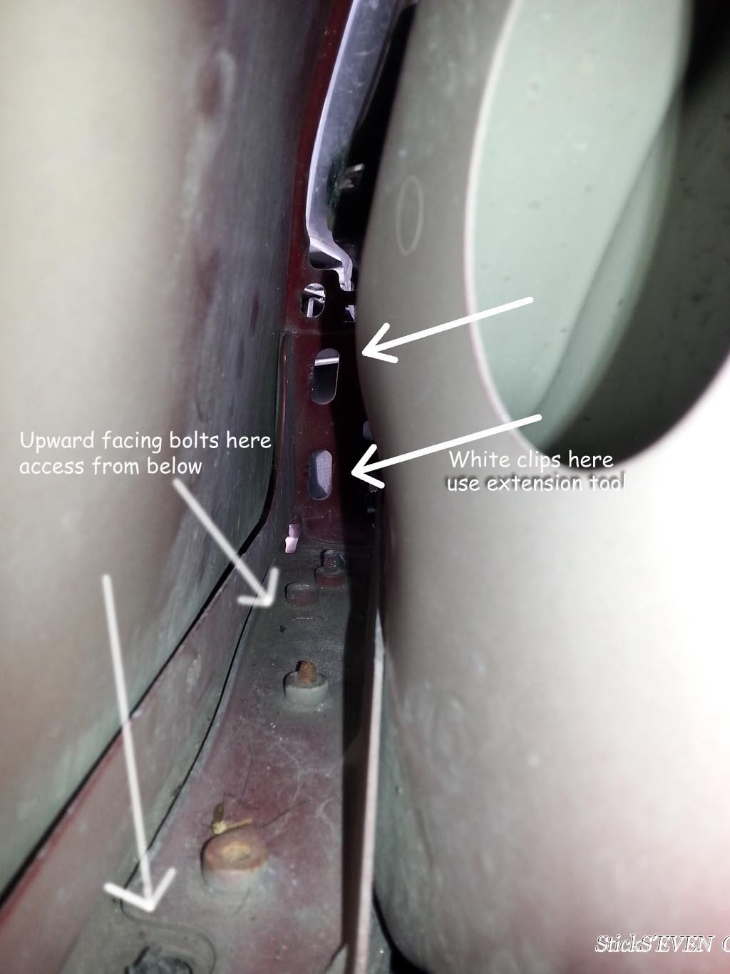

2 bolts per side, view the white "turn buckles" in the leading edge fold
Release the bumper D clips with a plastic tool, push it in under the bumper and work along one at a time
(View from Outside to help show clearly...this happens inside the wing ! ) :)
Using the tool I twisted the turn buckles, I used rod both reach and so I could use a spanner (tough to turn by hand)
edit
This is way to complicated.....bend some rod and thin the end.....I was experimenting as I went and the welder was plugged in :)
Then pull the bumper forward wriggling as you go :)

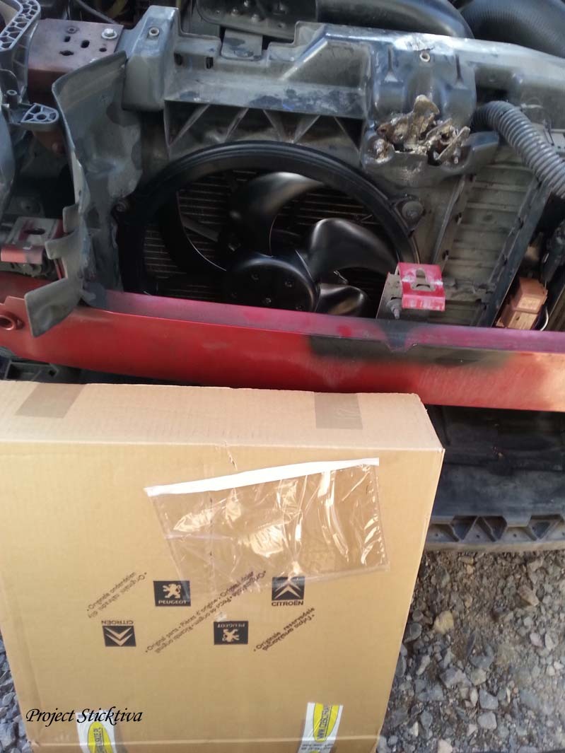

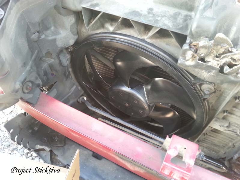

Rad cooling fan has gone I think....the relay "clicks" with 12volts supplied to it so the £16 part is OK but the fan does not work....so it is stuffed I think.
These fans are "two-speed" so cheep replacement ones do not work and you are limited to an OEM one (I Think? )....does anyone know a good well priced source ?
Citroen about £500....Ebay £350
Posts: 11836
Joined: 28 Mar 2013, 21:05
x 2005
Re: C5x7, fan not on, Removing the bumper for access
Unread post by Stickyfinger »
New fan ordered, £225 from Poland, £12 shipping ..2 days....Original PSA part 1253T3 (updated) fan unit
Posts: 11836
x 2005
Job done,
I "raced" myself and to a grand total of 14.25 mins to get the bumper back on and all lights working/in-place and the bonnet down.....why was I worried by the bumper off/on ? , an easy job and I urge you to DIY if/when needed.
