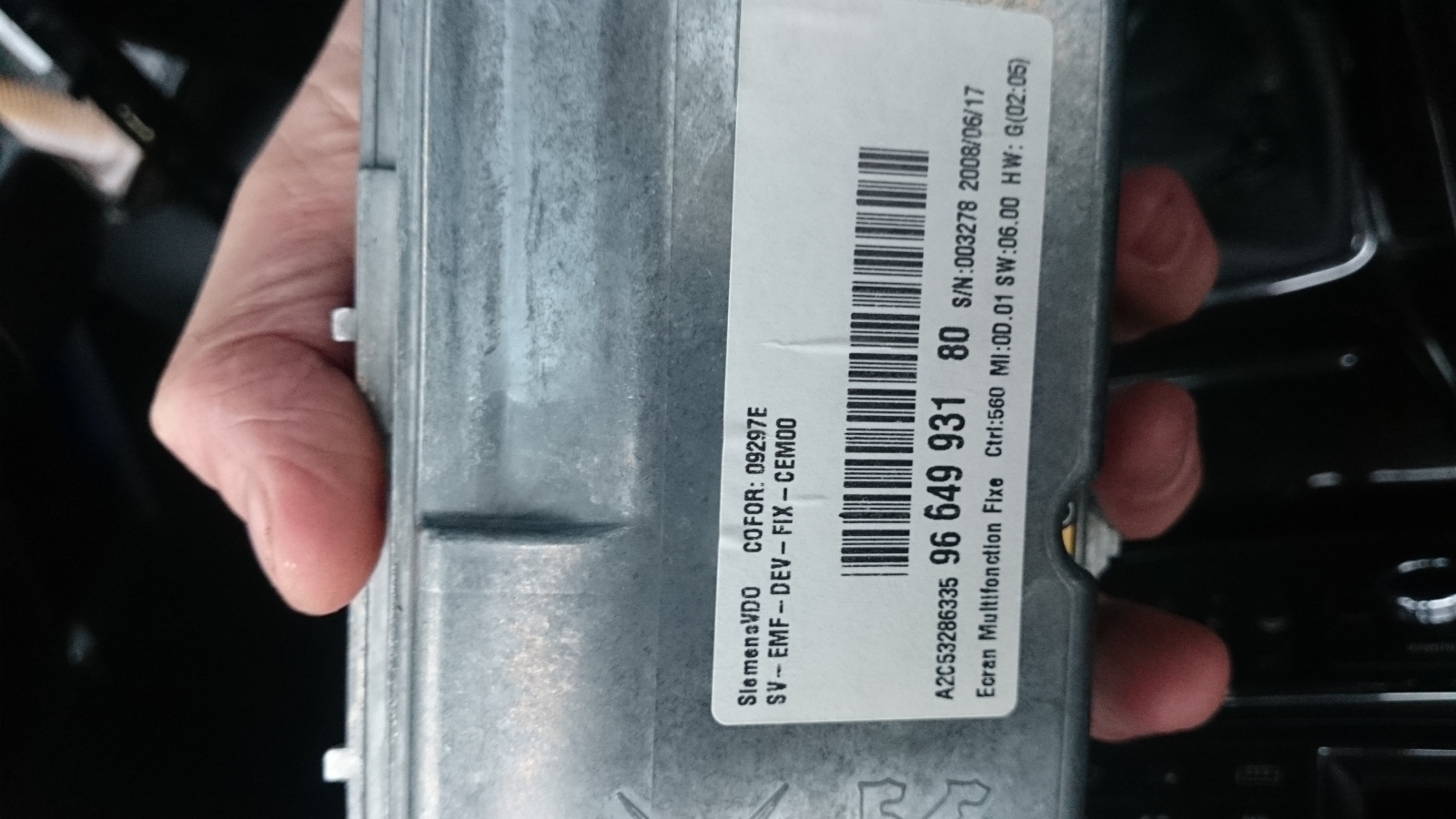

i believe its the rt4 with the hdd they screens are different to the one thats in mine. see pic its a different code and different back

There appear to be quite a few different part nos, no idea what the real differences are!

If you post up the last 8 digits of the VIN I can confirm the exact part number - I suspect it is used in other cars as well, so should be able to provide a list that may help with finding a breaker.

The last 8 of vin 54042557

Yours is:
02
6593 71
RP 6593 Q4
01
01
DISPLAY
So originally 659371, now replaced by 6593Q4.
659371 also used in some C4s;
6593Q4 also used in:
1 document(s) found for C4
1 document(s) found for DS3
1 document(s) found for C5 (X7)
1 document(s) found for C3 (A51)
