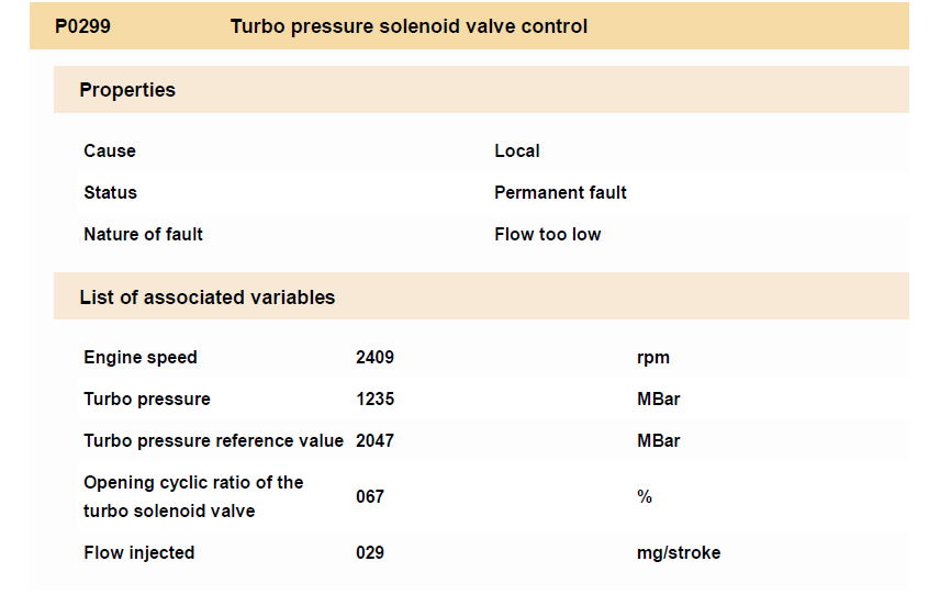

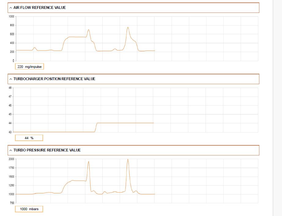

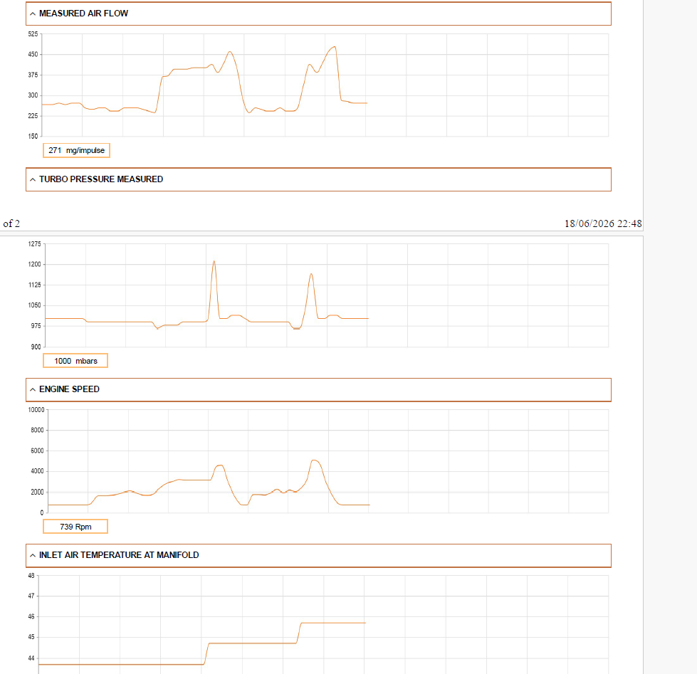

It has been a year since I bought my wife a 207cc (1.6hdi from 2007) and since then we have
been unable to make it work fine. It has a low power condition that makes it impossible to
reach more than 60mph even full throttle in third gear... I have the same engine on a C4 and
I can confirm this one is completely off.
I have swapped glowplugs, the fap additive tank, the maf (2 times), charge pipe, valve cover
and a few more points of conflict. I had it smoke tested for leaks and made sure the turbo
works. Sadly none of this have fixed my problems and I'm starting to loose hope.
I have taken a bit of live data:
And the related code:
Everything seems to point out to a turbo problem. But I don't have enough knowledge
to tell how to proceed from here (I'm not a mechanic, just a guy who likes to fiddle with cars)
If anybody has ideas, I will test them and update this post.
All help is appreciated.
Best regards!

As you have already swapped a fair few bits I'd suggest replacing the turbo pressure solenoid valve which is not too expensive. It may be you have a vacuum leak in the system so check that there are no vacuum hoses broken while replacing the valve. :)

Our 2.2 hdi C5 had a P0299 code that popped up occasionally but did not put on the engine light and was found with a code reader. Live data showed the MAP sensor (boost pressure) was not changing much as the accelerator pedal was pressed. I replaced the MAP sensor and that seemed to fix it and it accelerated a lot faster. The old one was bunged up with oil. A couple of years later the code appeared again but I did not do any checks. I also replaced the MAF sensor but that made no difference.

Is this a 90 BHP or 110 engine? I think the 90 uses a waste gate whereas the 110 uses variable geometry. Either way the turbo control should be free to move. If it's 110 the actuator should pull down when you start the engine, and it should be easy to press down and spring back when the engine is off.

RichardW wrote: 19 Jun 2026, 22:57 Is this a 90 BHP or 110 engine? I think the 90 uses a waste gate whereas the 110 uses variable geometry. Either way the turbo control should be free to move. If it's 110 the actuator should pull down when you start the engine, and it should be easy to press down and spring back when the engine is off.

There's no visible spring, but it's right on the front of the turbo between the two halves. You should be able to push it down relatively easily engine off then it should come back up quickly - if it's stiff or doesn't come back smoothly the internals are sticking.
