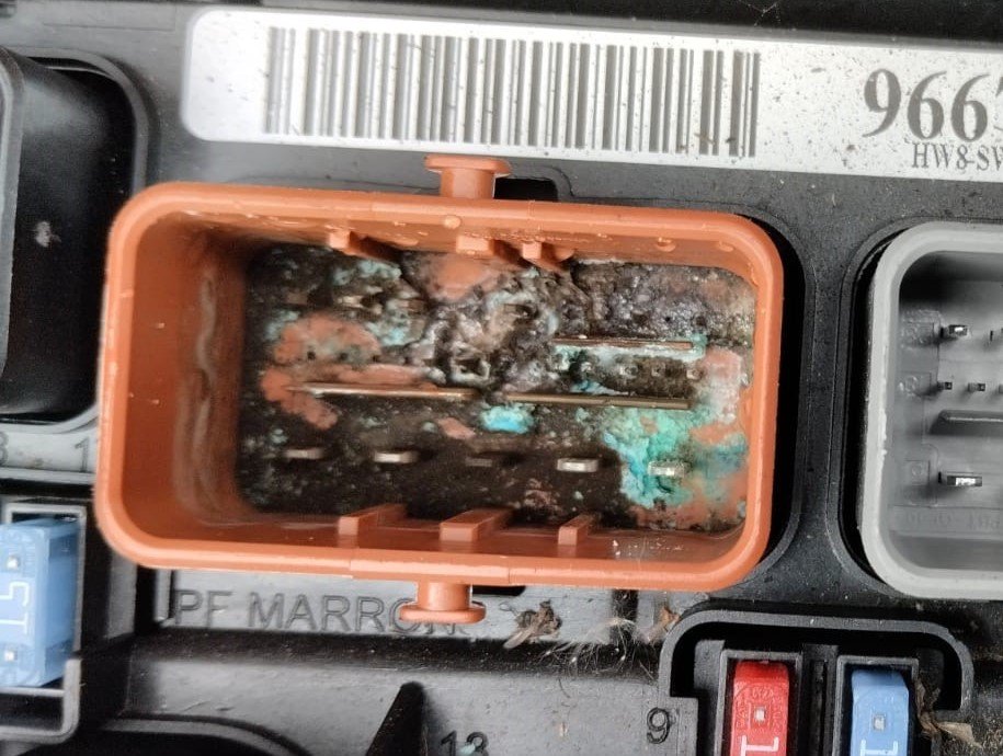

I've had a number of electrical issues on my 2010 207 1.6 Vti Automatic recently. The main ones being an ABS, power steering and speedo issue which I traced to a burnt out fuse box at plug 28V MR

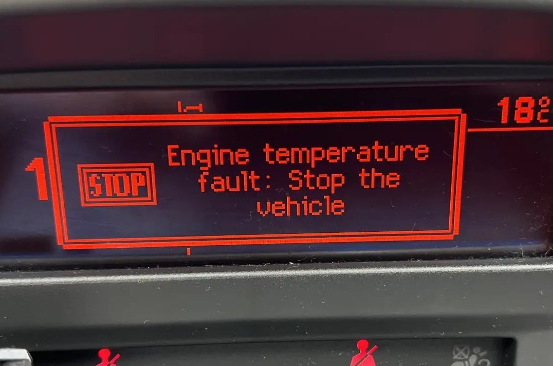

I replaced the fuse box (same part number) and the 28V MR connector (soldered the wires) and this has solved the ABS issue however I now have this Problem 10 seconds after I start the engine and the cooling fan also comes on:
I assume this is connected to the 28V MR plug? Does anyone know which pin is related to the temperature sensor or suggest where I start looking?
Thanks, I hope someone can help.
STOP! Engine Temperature Fault- Car's not overheating

Re: STOP! Engine Temperature Fault- Car's not overheating
Could be the coolant temperature sensor is faulty. Plug in a code reader that does live data and see what temperature it is suggesting. Also check its connector/wiring, it may have been disturbed when you replaced the fuse box.

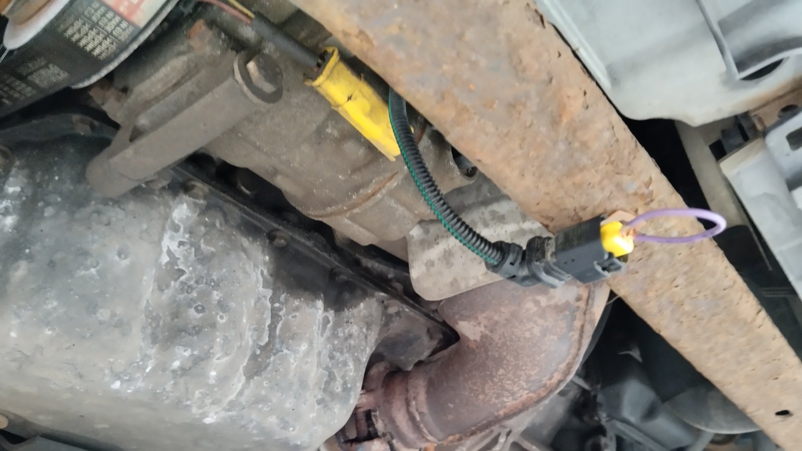

I did however still have an engine fault displayed on the dash. The code was 0994 and relating to the air con. Now that's not been working for about a year so why is it throwing up a check engine light? Who knows? But thanks to a knowledgeable guy on YouTube if you short out the wiring to the AC all will be good. And don't you know it, it bloody well is!
Why does a non working AC unit trigger a MOT failed code that can't be cleared. That's not right. Here's my temporary test.
