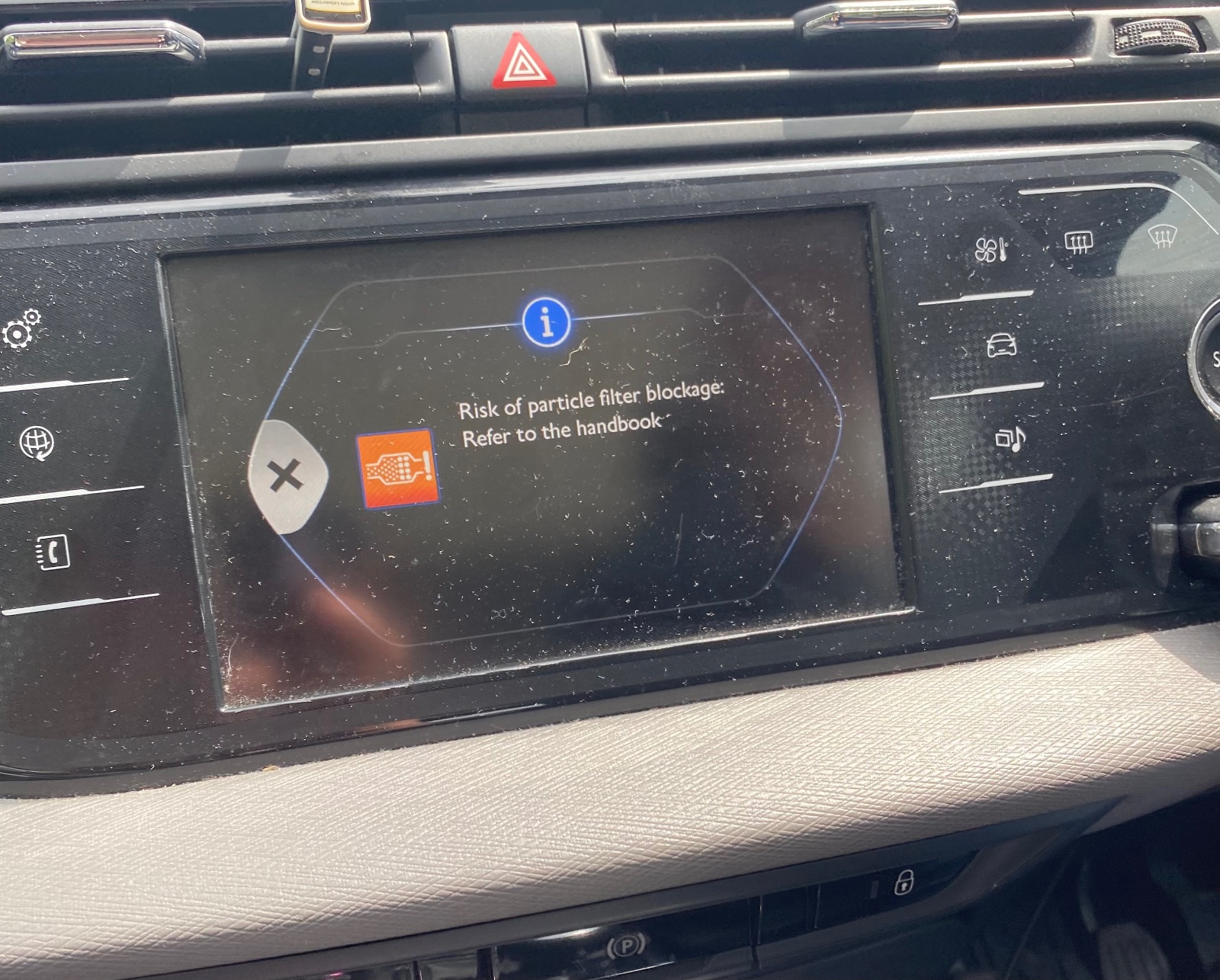

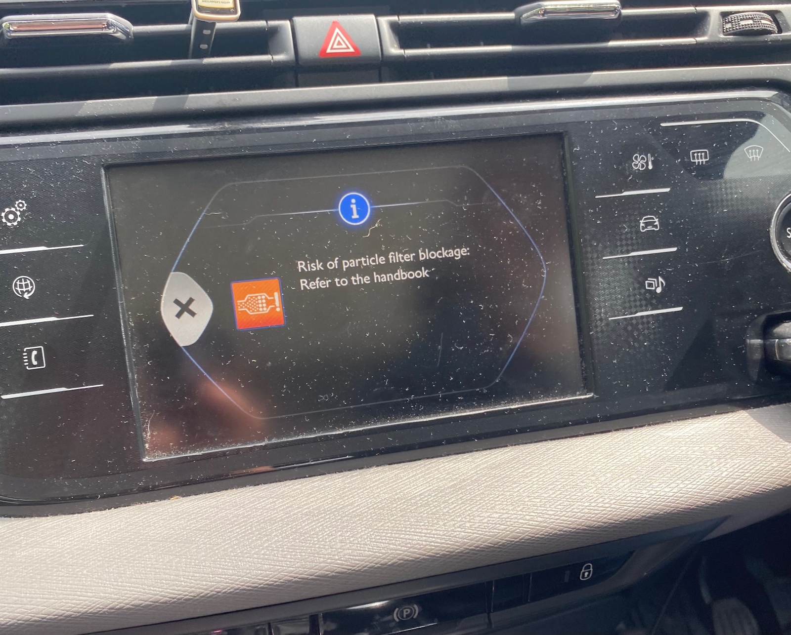

I thought perhaps it was another brain fart as this car has had a few of them over the years but I was wrong, when accelerating up to 72 mph the warning light came on and bleeped and I got the message *Risk of particle filter blockage* Refer to the handbook.
It did this several times on test runs afterward ,bogging then the message coming on.

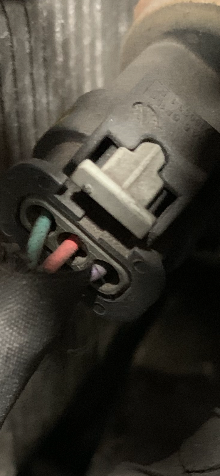

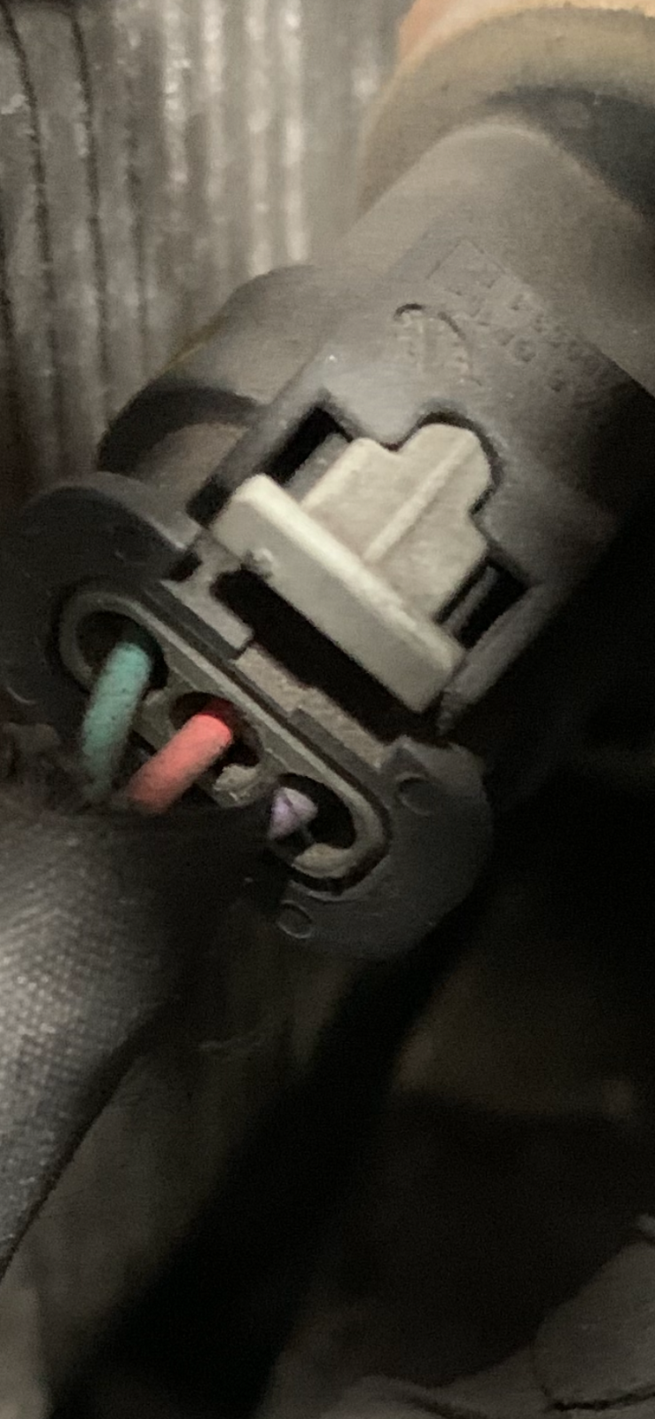

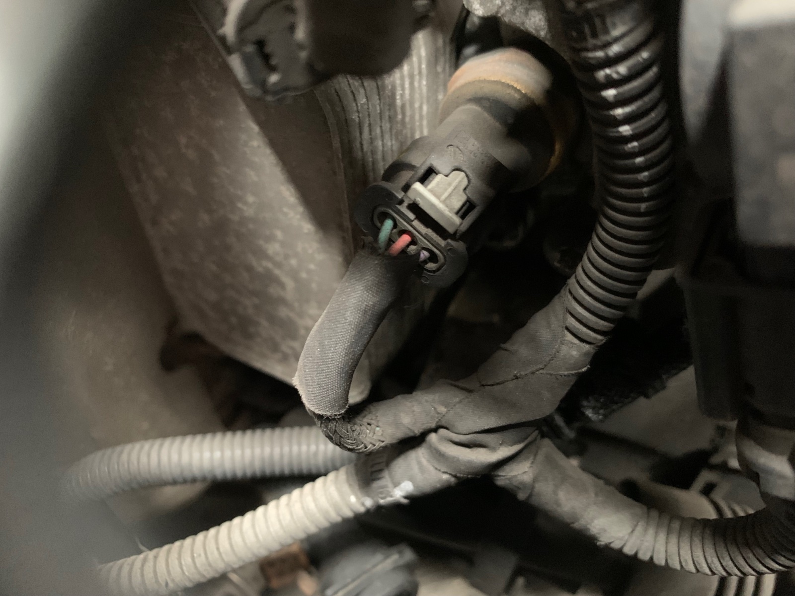

Is this the Oil Pressure Switch on a C4 1.6 Diesel Picasso Grand 2016 ?
PaulC5
- Posts: 2345
- Joined: 06 Jun 2023, 15:26
- x 588
Re: Oil Pressure Switch ?
Could be, it looks as if it is next to an oil cooler. If you can get a socket over the connector part you will probably need a deep one.

For future reference to others doing this job:
This is the Oil Pressure Switch on a 2016 1.6 Diesel Picasso Grand and is easily accessible.
It is in the front of the engine about half way down next to the oil cooler nothing needs to be removed to get at it.
The hardest part of the job by far was getting the electrical connector off and even harder to get it to snap into place on the new Oil Pressure Switch.
To get it off pull the grey locking tab towards you then press down and wriggle gently.
To get it back on I found a smidgeon of washing up liquid eventually helped but push down on the grey locking tab and gently wriggle back in place until you hear a click.
Tools required are a 24mm deep socket.
