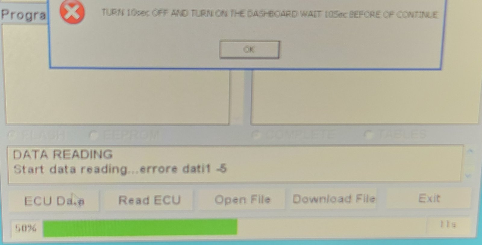

Hi, I'm in NZ so don't need a DPF on my car. I am trying to disable the DPF and eolys fluid using the Galletto 1260 EOBDII cable.
Problem is that when I plug the cable in and try to read the ECU Data with the included software it doesn't complete the operation. I have tried all the different drivers and the only 2 that get to 50% before giving an error are the:
Bosch EDC 16 C3.9 FLASH 29BL802CB
Bosch EDC 16+ C34 FLASH M58BW016xB
Screenshot of the error when trying to read the ECU:
Am I missing something or is my car not covered by the software.
My car is a 2008 C5 III 2.2hdi
VIN is: VF7**************[VIN obfuscated, can be read by forum staff]
In Lexia I can't find an information section that shows the ECU model and version but when I go into BSI it shows EDC16CP39.
Any help to get this working would be great. Thanks.
