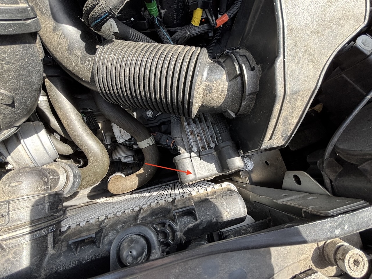

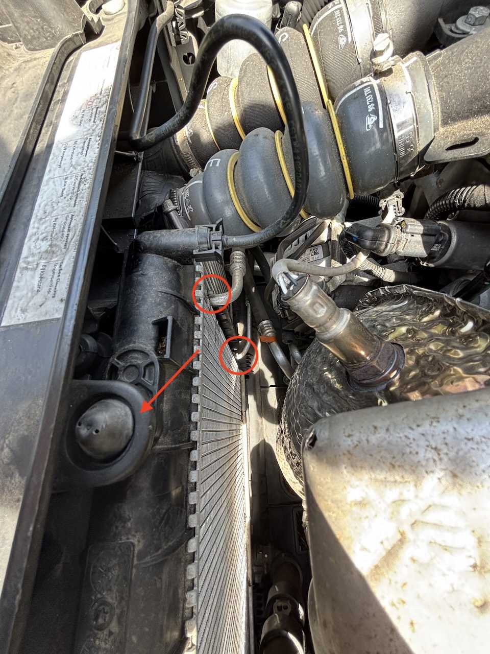

As preperation and before I'm going to buy parts, I'm trying to figure out if I could replace the condensor myself. I've checked if it's possible to unbolt the bottom pipe clamp. Although it's a bit of a squeeze, I believe it's possible. The thing I'm figuring out now is how to 'unclip' these 2 connection points for the radiator (marked with the arrow in the picture below). It seems there is a allan bolt on the opposite side of the ring. Should that be it?
The other hurdle I'm facing is getting the radiator off to the side, once the condensor pipe's are disconnected. Bellow I've marked the biggest obstacle to flip the radiator so I can get the condensor out. I'm hoping I can just move the radiator a little to the left so I can get past this obstacle. Does anyone have experience with this?
